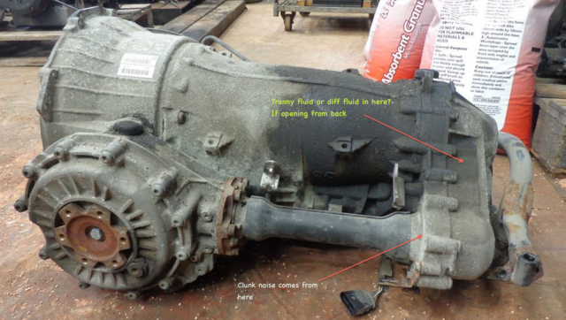

Well I am stuck.
Mechanic pin pointed the issue exactly to the spot on the picture. Whining and clunking there.
No one is willing to take on my car and just say get a new tranny
This is the problem
Issue is right in here :
Old Sep 4, 2013 | 04:04 PM
  #59
pumptech's Avatar
Joined: Nov 2010
Posts: 1,030
From: houston
Rep Power: 82
pumptech has a reputation beyond reputepumptech has a reputation beyond reputepumptech has a reputation beyond reputepumptech has a reputation beyond reputepumptech has a reputation beyond reputepumptech has a reputation beyond reputepumptech has a reputation beyond reputepumptech has a reputation beyond reputepumptech has a reputation beyond reputepumptech has a reputation beyond reputepumptech has a reputation beyond repute
There is a roller bearing in there and only one place get it. This place in Lithuania or something. It's pretty cheap tho. I've actually got 2 but they are used.
http://www.lodixtrade.hu/webaruhaz-termek-F-232848-&lang=en
Any leak should be able to be fixed with gasket set IPT has.
This is NOT a difficult fix for a typical mercedes transmission or other qualified shop provided the bearing is truly the issue. That cover comes off and the bearing is housed IN that housing. I likely have a photo at home.
Originally Posted by maor
Well I am stuck.
This is the problem
Old Sep 4, 2013 | 04:07 PM
  #60
maor's Avatar
Joined: Jun 2013
Posts: 54
From: uk
Rep Power: 15
maor is infamous around these parts
Dear Pumptech,
thank you for taking the time to read and reply to my problem.
1 gearbox rebuilder said a knocking can't come from a bearing, a whine yes but not a knock and that it's probably worn cogs, aka a new tranny time.
Another person said it could be the bearings causing the issue.
Everyone else wanted to take a look first.
What I meant was, if I take that back cover off where the yellow arrow is pointing, will ATF leak out or Diff fluid?
