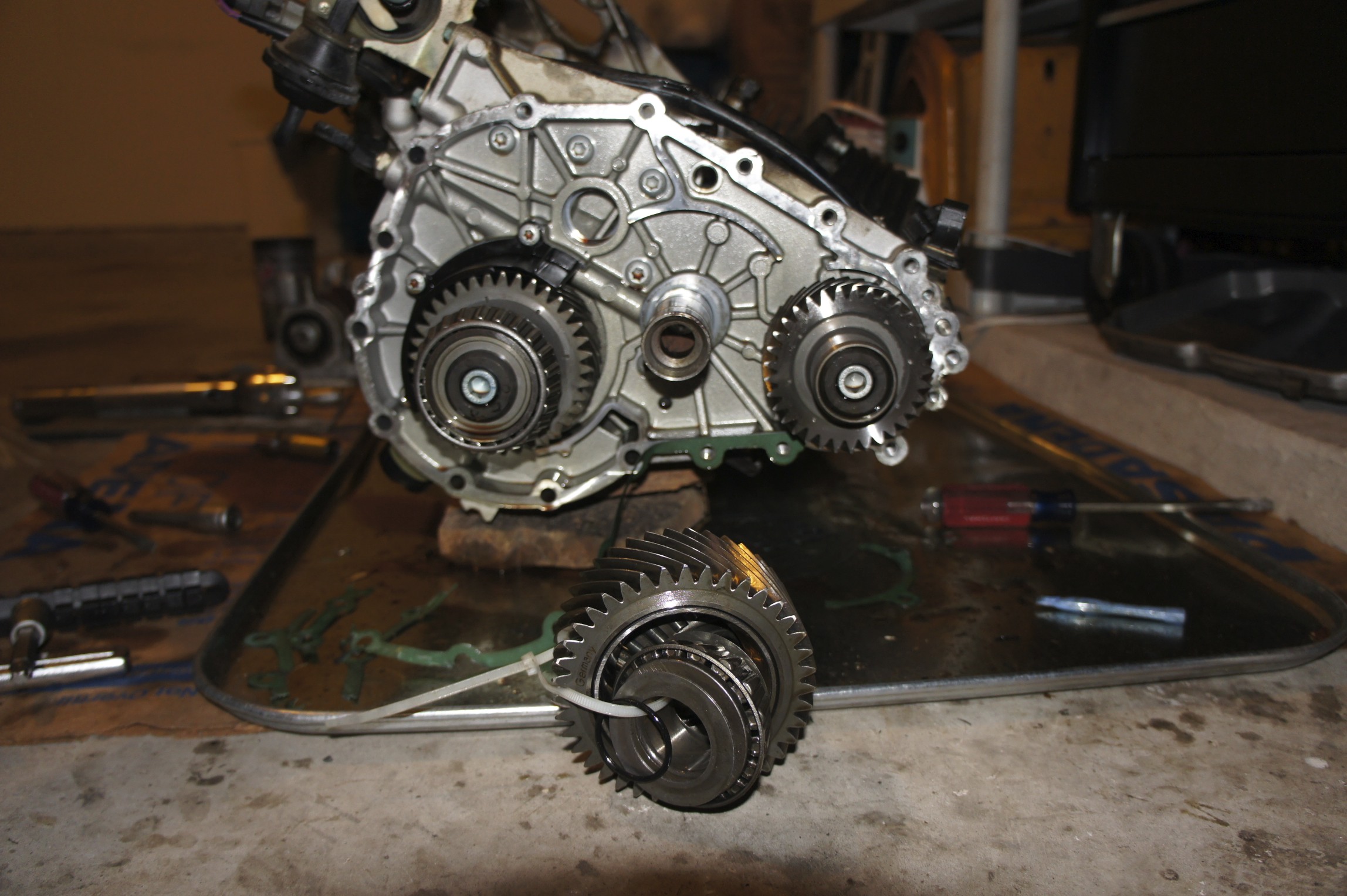

ahhh!! yes most certainly will leak. this is what it looks like in there. the gears in the foreground go on the center shaft. the output shaft gear (which turns front wheels) on the left turns the middle gear which turns the gear on the right. this, turns the shaft that goes along side the transmission (the one in the video) which turns the rear wheels. if that gear is messed up you will be SOL. i cant find that baby ANYWHERE!!

Should have pointed out.
This is a 722.6 C2s. So RWD only, not front wheels being driven.

pumptech has a reputation beyond reputepumptech has a reputation beyond reputepumptech has a reputation beyond reputepumptech has a reputation beyond reputepumptech has a reputation beyond reputepumptech has a reputation beyond reputepumptech has a reputation beyond reputepumptech has a reputation beyond reputepumptech has a reputation beyond reputepumptech has a reputation beyond reputepumptech has a reputation beyond repute
Lol...those photos are of C2, so it's the same. The 4WD just have a yolk on the end. Not a major difference.

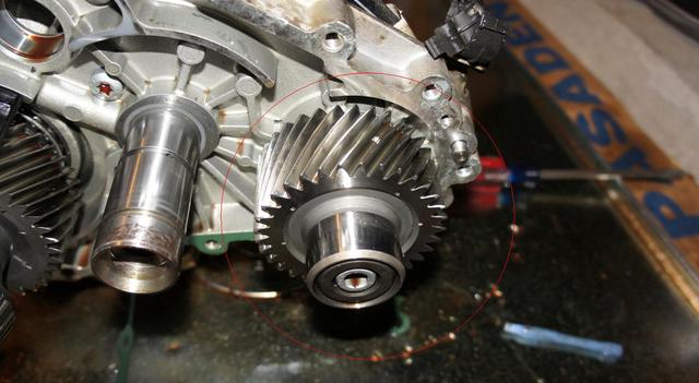

So my issue in theory should be in teh circled area?
yep...or the bearing seen in photo that receives it. that gear turns the pinion shaft that seems to be making noise in video.
the housing simply unbolts and with some manual encouragement comes right off. might as well drain the fluid, pull the pan, and change the filter while in there.

So basically I need to pray that it is that bearing that is causing all the issues not the pinion gear behind it.
It if it is that pinion gear then I am screwed.
If it is the bearing I have a future!

Would this have anything to do with the whine I get off throttle at 70 mph?
well..................
i have one, iv got the whole unit. the gear, the bearings, ring, pinion, rear differential, you name it! i even have a full rebuild kit ready to go! i have a tiptronic project ongoing as seen here https://www.6speedonline.com/forums/...ear-ratio.html but its on hold for a bit. im not convinced i can use the rear differential ring and pinion but im just not certain yet. its not unreasonable to think that i could get rid of some select parts, but keep in mind these are very rare parts to find separate. lets just wait and see what you have going on before we go down that road. il certainly work with you if its a part i think i can spare.
also keep in mind that you can get a working tiptronic off ebay for $2500 (plus removal and instal probably $1000) or less. if your problem is in the gear, bearing, or pinion you have some cost saving options but if its in the ring pinion assembly it must come out for repairs and would likely end up costing more than a replacement. if your repair estimate are anywhere near $2500 id just go with a replacement
if the noise is coming from coming from the end where the gear is i would put my money on the gear or bearing. if there is some play from the ring and pinion end (bell housing end) then it could certainly be a factor.
