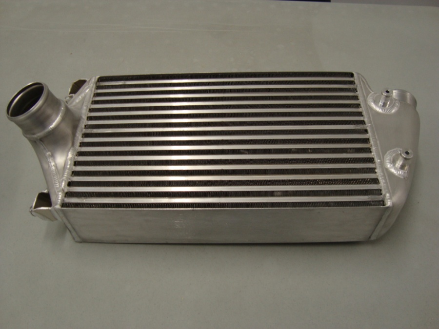

I have both stock 3.5x9x14(biggest possible fit) replacement BELL bar &plate ICs using STOCK hoses( no need for expensive aftermarket hoses) as well my 4.5x9x12 ICs as on some 1000-rwhp cars... We make them per order per spec...
here are the pics...
There are a few major restricitions on the stock ICs... take a look during R&D pics)
Your only using the center of Ic on the inlet side of the endtank... I opened them .... so we decided to actually use the full 9" wide endtank as in my pics....
and here are the BIG boys... On Rob MDs 1100rwhp car among others...
And here are the 6 inch big boys....

why your end tanks are so quadrangle??? it's producing a lot of back pressure.
below pictures of coolers secan class.....you have never seen such effective coolers......
