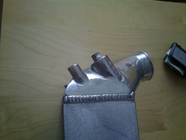

you should read this before producing end tanks.....
http://www.dvdtfab.com/intercoolertestlab.pdf

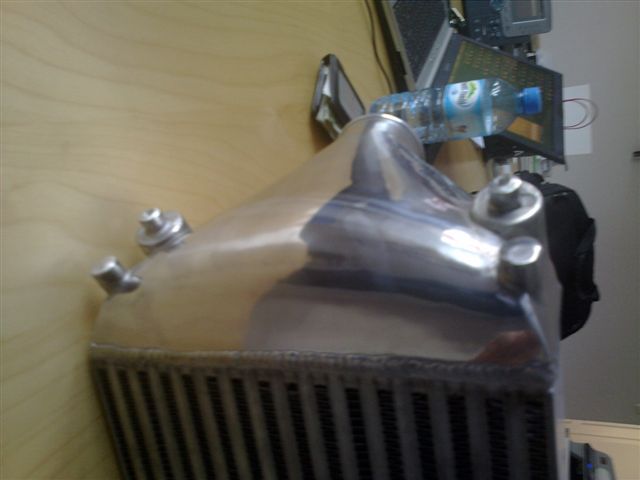

this is proper end tank for 996/997....
Nothing against this guy, as for the most part he is correct, although I think he "stumbled" onto most of the data. It looks like a highschool or freshman level college project and I have no doubt that his current knowledge would have incorporated a few other factors. The formula for FLOW is correct although he forgot to quantify the rest of the data. Without getting into too much headache, you also need to factor in gas(fluid) expansion due to heat(remember it can be 400+ degrees leaving the outlet of the turbo) AND pressure(as with a questionable core, the pressure differential can be substantial - and more pressure, more heat, more loss of efficiency). I would have liked to see this performed to a little more realistic level as far as pressures and heat go, not just flow. Definitely correct data though
Justin
Justin
please notice that he focused on the endtanks, that was critical for him in this test.
so you think quadrangle endtanks are better?
How exactly did you reach that conclusion from his post? He was pointing out things not taken into account in the paper you linked. You might want to read his last sentence a little more closely....
why your end tanks are so quadrangle??? it's producing a lot of back pressure.
below pictures of coolers secan class.....you have never seen such effective coolers......
hey markski, check out the real deal. i think they use these on f1 cars. you're an expert on intercoolers now? i think i'll go with awe. wish i could afford those seacans though
Um , ok so they may be better and say you gain some extra power but at 25k is it worth the difference? Lol seriously I don't think so! So just lay it to rest.
Also Alot of 1000 whp cars over here are running as you call them"quadangular" end tanks , and putting the smackdown on all of the competition overseas.
I wish I could find a customer in Poland as I would set him up at cost with my 800hp kit.. trust me that you guys would need something strong to compete... and all that for 1/4 of the price... you ever wonder why Switzer is beating everyone up in Russia with his 997tt builds?
I have nothing bad to say about Secan... if you can afford it God bless you... I am sure they are far and above being 1st class...
All I can say is that I developed ICs on a few cars including mine and we put down 1000 to 1100 rwhp... all that on my ICs... so here take a look at these dynos and a 60 to 130... not bad for a Polak...
best
marek
Im going to knock you out on this one LOL ... Albert is my good friend who lives in Chicago, is an engineer, and did my first end tanks 4 years ago... and wrote that study you just quoted... here is my proof...
BTW, they did make 871rwhp... I now make another 150+rwhp...
take a look at the pics from my car 4 years ago...
I am not competing with Secan... nor saying mine are better... what's up with your hostility?
any questions?
Woof !
Once there is a high pressure area built up in certain areas of the end tank, and there are various velocities to deal with, do YOU think it matters as much as to the absolute design of the end tank?
Additionally, are you telling me that heat and pressure do not affect the flow through the endtank itself? I was merely pointing out that the data is inconclusive in a turbocharged automotive application. More information is needed, that's all.
I suppose a trapezoidal quadrangle design would be the better design out of the quadrangle designs. Incidentally, where did I say that a quadrangle design is better than one without any angles?
