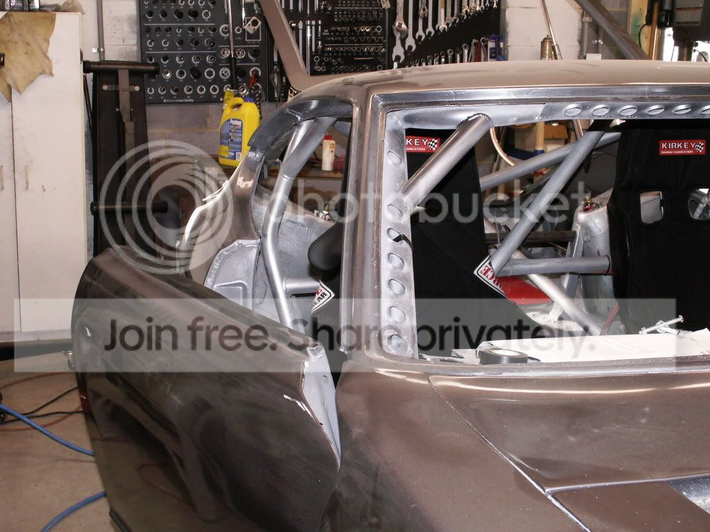

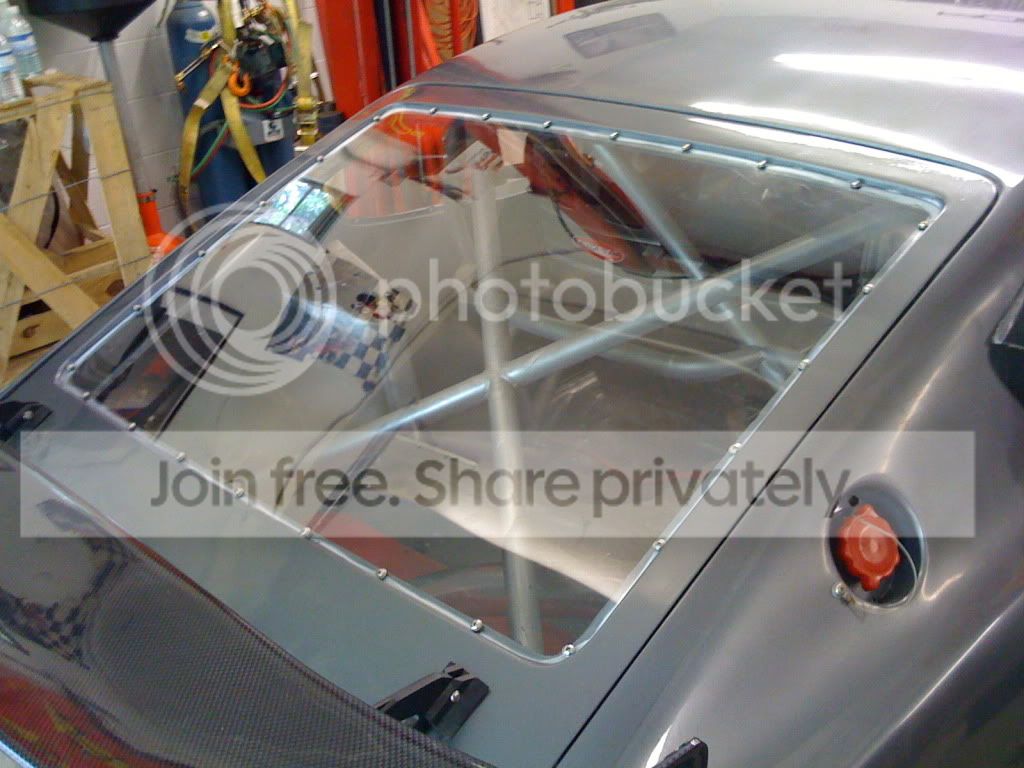

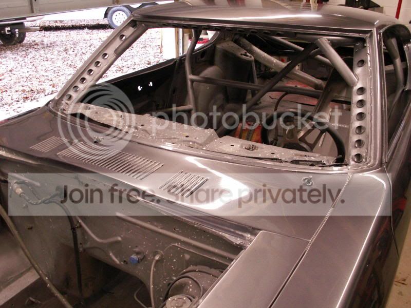

Yea, that's a good question we need to ask the OP... Roll "BAR", or welded in "cage"? If you're talking about something like the DASPORT bar, I don't consider it worth much more than holding my harnesses for my track seats.
A cage is more risky for "casual" contact, so just beware, they're not street/crash friendly.
My DASPORT Bar
Notice no cage in the front interior area?
A real cage - The cage in my Datsun V8Zcar...
So what is it you really want? Cage or roll bar?
Mike
