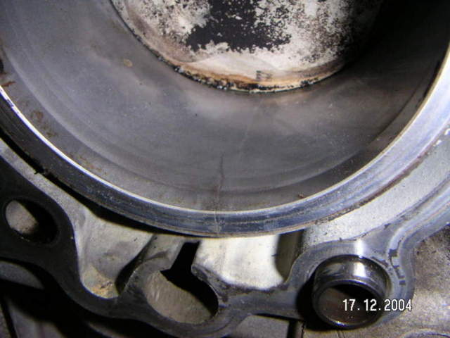

UPDATE***** I took my 2001 C4 to the mechanic and he dropped the engine and took it apart. He found a small crack in cylinder 1. Does anyone know if it is worthit to fix a crack in the cylinder wall? Any advice would be great! thanks!
I also have pictures of the cracked cylinder if needed... thanks again!

Pic plz

its a normal 2001 911 c4. here is the pic. Any idea whats the fix?
