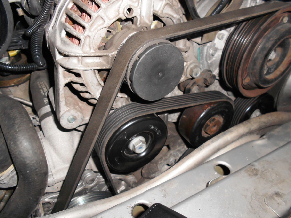

Hi,
My mechanic has installed the pulley. Is not easy remove the old one!!!
He could install the same belt but he needed to change the belt turns from the defection roller. THIS COULD BE DANGEROUS???
He will go test it...

"but he needed to change the belt turns from the defection roller".
What exactly do you mean by this ? I'm trying to understand as doing mine in 48 hours
See the images...and find the differences.
Name:	Belt Pulley Turns GT3 RS.jpg
Old Jan 31, 2013 | 04:56 AM
  #110
RCH's Avatar
RCH
Joined: Jun 2004
Posts: 1,704
Rep Power: 94
RCH is just really niceRCH is just really niceRCH is just really niceRCH is just really niceRCH is just really nice
Ok with you, it really does indeed seem that OEM TT Pulley is larger than the EVOMs & GT3RS wheels which are the same size & that you need the GT3 Serpentine Fan Belt part number 996.102.151.93

And in prior posts on this thread others said it was the the same size pulley.

VAGscum was the first to mention it and then to back up his point he puts a picture of a GT3 and a GT3RS pulley together showing they are the same size. They are, just not the same size as a TT...
The part number for the belt is written on evoms site, it is a GT3/GT3RS belt 996-102-151-93
Also, look at AMS website they say:
The EVOMS pulley is also slightly smaller (same size as the OEM GT3 pulley) which under drives the accessories, thus reduces parasitic drag and further improves engine efficiency
Underdrives the engine accessories at the OEM specified range. ~15% (Same as the OEM GT3/RS)
And they do include the belt when you buy it for a TT

Ok got the GT3 belt this am, its 40% cheaper than the TT one fyi DDAY tomorrow morning

Ok got this done this am combined with taking some more baffles out of the exhaust which involved quite some engineering. Firstly its a MAJOR job, you need a jack to support the engine as the 4 bolts for the plate which protects the exhaust from the flywheel bursting loose & hang the exhaust on, also are engine supports. I did this with 2 other people and there is certainly no way you can get the GT3 RS fan belt back on your own. I will post pics later
Does it change the driving experience, not in anyway like simply fitting the Sprint throttle booster box does but I'm sure it all helps

The GT3 Belt is clearly shorter, pics coming too
