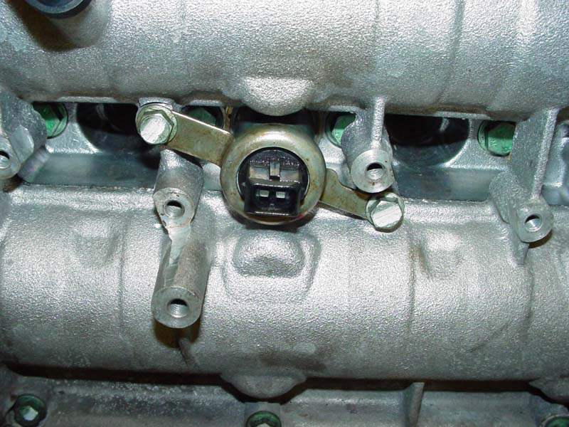

I think i know what you are talking about with the spark plugs, but I can't find the thread on renntech. On the top of the heads, between the first and second plug is a brass cover for something (cam sensor or something) that has a tendency to break one of its mounting tabs. I think it is a cheap part and worthwhile to change if you are in there. Hopefully someone has a picture in the shop manual they can post up to fine the PN for it.

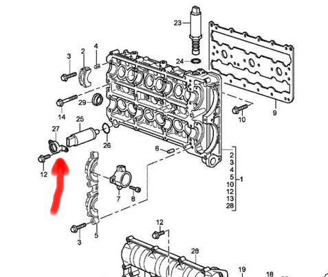

If you are talking about this one it is in fact a TSB. Valve lift solenoid. This bracket (#27) can fail.... Good thing to check while engine out... Good suggestion from D_Nyholm...
Thats the one!! Thanks jpflip!
