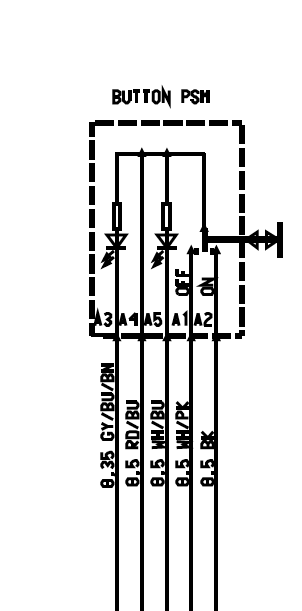

Steve, I got the wiring diagram and there is 5 wires going to that switch....There is one more thing you can do while the panel off. If you look at the wiring diagram you will see the "on" "off" wires are , one is black and one is white and pink. If you jump these two wires , while the engine is running, and if the light come on that means the switch is not working properly. As a jumper you can use any small electric wire but be careful to touch only those two wires.

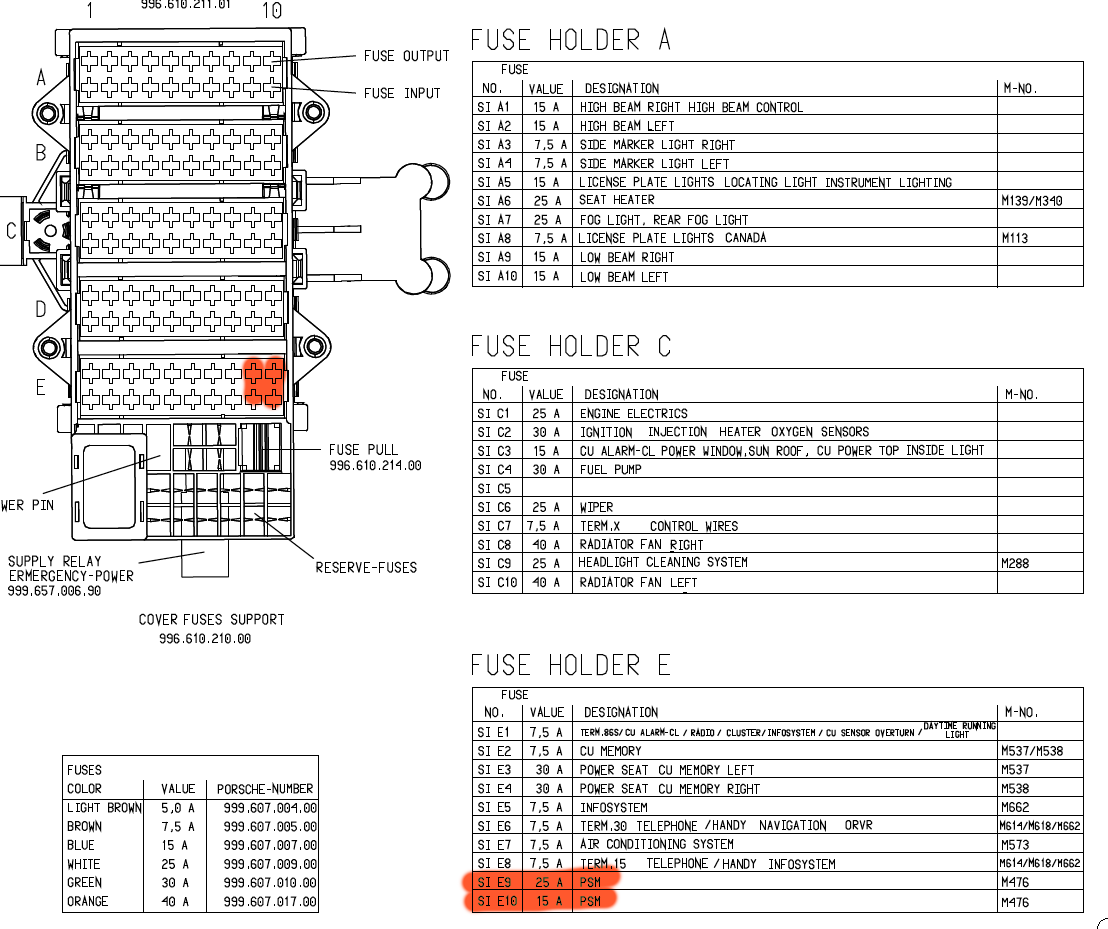

fuse!!!
Also take a look at your fuse box. The fuse E9 and E10... Never know...

Fuse was blow. Everything works perfect now.
Thanks a million for your help.
