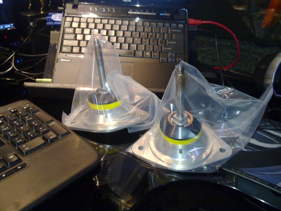

Yellow Wevo mounts are in
Hi Guys,
To the original poster, how do I detect knocks (or its count)? I see no ill effect that I can feel/perceive so far.
Was there a noticeable change in the car? I can post pix of my new mounts that went along with the a new 997 Tranny mount.
Regards,
-Arman
