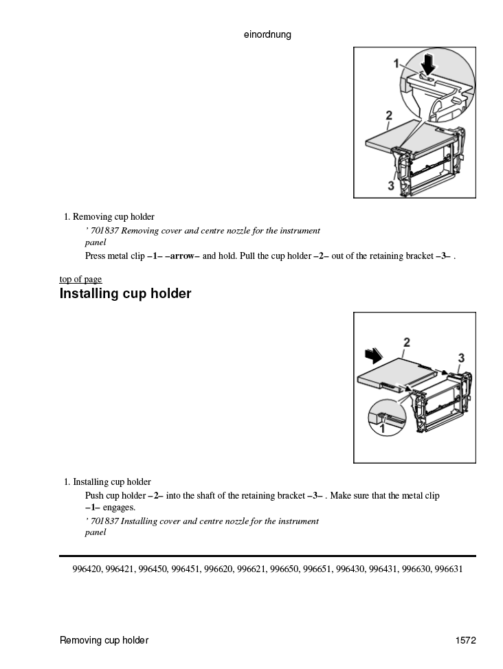

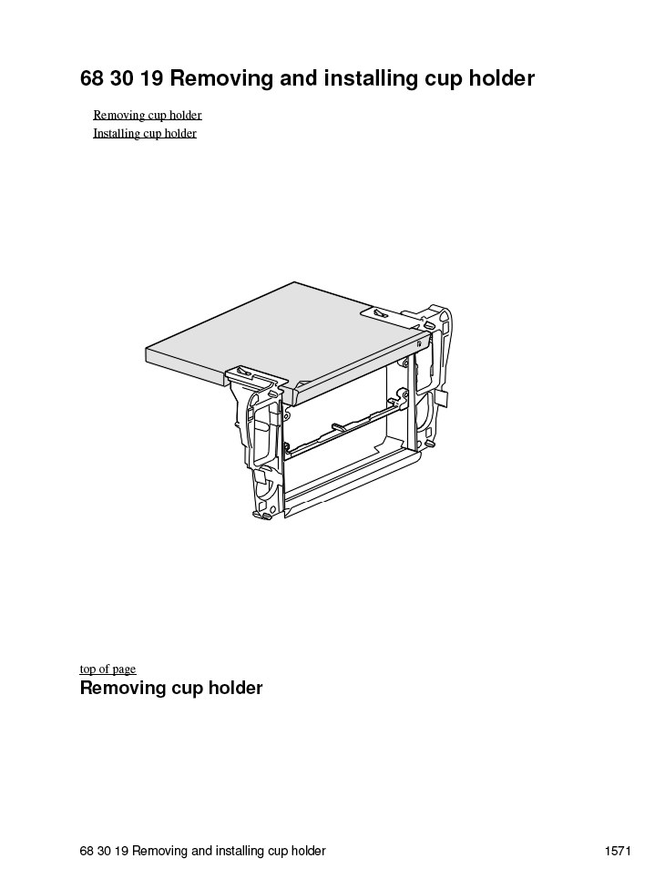

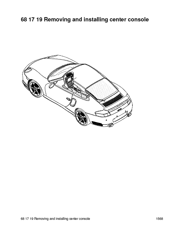

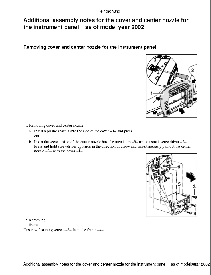

Ari, I did it with the repair manual. The pictures are not great but the explanation help a lot....

Second parts...

Ari,
Insert a flat screwdriver (taped over) toward the bottom of the horseshoe. Pry that up slowly and move up as you do it. The two dials on either side can't be taken out until you take out the horseshoe.
