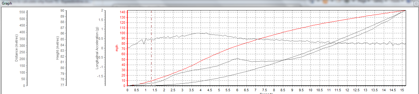

Hi,
All I done was a second gear start, with a poor 0-60mph time, but I did travel 402 metres and the speed was as stated 129.xx. THe time was poor because of the start.
Here is the chart.
And it was on a 17% incline over the 402 metres.
Am I misunderstanding something here - a 1/4 mile time is to travel from stationery to 402 metres and the TS is the speed at 402 metres?
Ken

It is. I have a Microsoft Excel spreadsheet that I use that is dead on accurate. What's the weight with you in the car?
Using 3,600 lbs it's 519 rwhp.
Also, looking at your chart your incline is around 3% or so. Not 17%.
