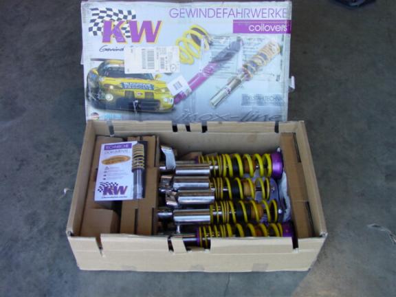

KW suspension
Has anyone tried KW coilover suspension. How do they compare to PSS9?

i can't tell if those are the V2s or V3s... In general it'll ride much more harshly, especially if it's the one with the camber plates etc....
I know Todd used to carry them but doesn't anymore.

It is the variant 3, not sure what the difference is though

OK the V3s are their top of the line ones. They WILL ride harsher... They have solid pilowball mounts and of course the camber plates. PSS9s have neither and re-use the stock rubber stuff. The spring rates are more aggressive also. Depends what you want the car for? For a comfortable street ride just get PSS9s and if not then obviously look around. I wasn't keen on the KW stuff personally.

dlm477,
By the way, the set you have pictured will work on the GT2 but not on the Turbo. The front canisters need to be mounted at an angle on the Turbo version due the 4wd setup.
My guess is the Turbo set works on both the GT2 and the Turbo; the GT2 set will work only on the GT2.
