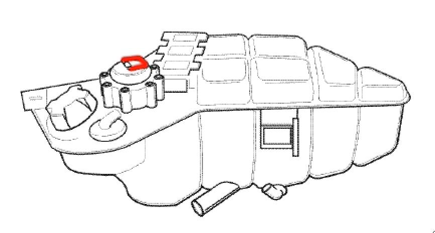

So far you did the wright thing. This was discuss many times and some people got different approach. The one I used is the one from Loren on Renntech which is: "Just open the bleed valve on top of the coolant tank. You can drive around with it that way and it will help purge air out of the system. Just check the level every few days and add coolant/water until it stops going down. Then close the bleed valve." Keep an eye on temperature and regularly add coolant fluid until the full mark....
The bleed valve is located on the coolant expansion tank cap. The small metal handle...
The dealer used PST2 or PIWIS functions....

Would you mind snapping a picture of this valve?
Of course. It is the small metal handle on the expansion tank cap. See pic part in red....
