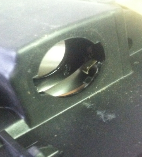

My drivers side just went out (blinking fast no indication front or rear). Plan to just look at the pins before replacing a bulb...will report back in a few days. Thanks.

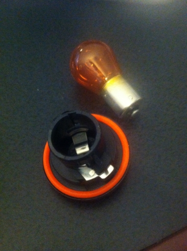

I pulled the headlamp assembly per the attached instructions. The bulb filament looked fine so I went and bent the tabs on the bottom and sides of the female part (see first picture). I also bent the one tab on the inside of the headlight assembly (second picture). Upon reassembly everything was very snug and worked fine. I hope the instructions and pictures help.

Based on the suggested fix, I carefully inspected both contacts on the male bulb housing. Sure enough, one showed minor burnishing of the contact & a roughened contact surface. At this contact there is also minor melting of the plastic that's in direct contact with the metal contact.
This must be the high side of the lamp & there must be intermittent contact that is actually heating the contact & the leaf spring. This localized heating is the culprit, the cause of the failures! The contact heats up, its surface roughens, it transfers heat to the leaf spring & the spring relaxes over time. This heating causes the melting of the plastic at the high side contact also.
