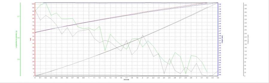

Enrique,
May be more info than you want, but here are some of my PBox plots before and after the 75mm TB/IPD Plenum mod. The red line is mph after the mod and the blue line is mph before mod. The green line is acceleration in gs after the mod and the black line is accel in gs before.
As you can see the mod gives faster spool and higher low range power. Power in the mid range is closer but still more after TB/plenum. There is also significantly more high range power. Overall the car goes 60-100 mph in 0.2s less after the mods. This is about a 6% improvement or roughly 30whp at this power level. The car was a GT700. Atmospheric conditions were essentially the same.
The TB/plenum were a PITA to install due to cramped work space but if you can lower engine a tad it is much more accessable. I have experianced no reliability problems.
If you cant see graph well enough, download it and magnify it in PS or similar photography app...
Not going to knock it because I have one myself... are you talking about the TB upgrade or the Tb and some plenum? if thats the case then the figures you mentioned are not really due to just the bigger TB...
Also, your set up may have done it but that does not mean someone with stock injectors, 18gs for example, will also add 30rwhp....
If we start adding HP based on parts added then what if I add the plenum to the turbos( 30rwhp) then the headers, (15rwhp) then catless 3" exhaust(15rwhp), then bigger hoses and Y pipe( another 30rwhp).. you soon will end up with a 800rwhp but in reality its 650 lets say....
Dont get me wrong I have all the bells and whistles on my car... and I cant get 30rwhp more just by swapping TBs... but in your case I think your talking about the complete TB and splitter..... and will that help? sure.. but differently on each car...
I would rather put that $1600 into a turbo upgrade then the TB... but thats just me...
BTW, not disputing your findings... I just have my own view based on experience on a handful of builds... including my own...
I agree with you Mark...
My results are with both the TB and the plenum. I think if Enrique is going to do the TB he should also do the plenum since the stock unit is a disgrace for such a fine car.
I agree that its easier and cheaper just to slap big turbos on the car and force the air through smaller passages. However, I wanted to keep the small turbos on my car because I liked how it drove on the street.
Sure his results will likely vary from mine since his car presumably has fewer mods.
