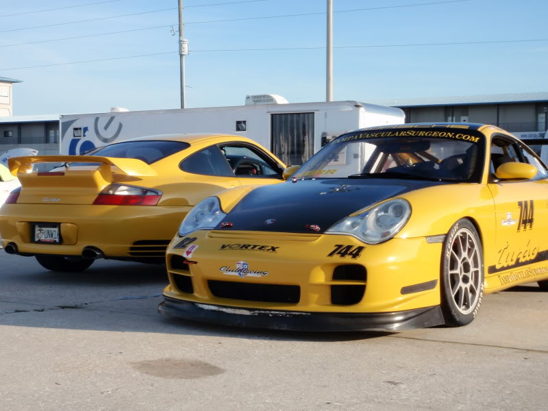

Thanks for replies. Yes a few forum members are running these. but most are using Hoosiers which from what i understand are smaller in diameter for width as compared to street tires. And some have major alignment tweeks.
Understand the diameters need to be kept with in 5% of each other. anyone have street tire size recommendations for these wheels that don't rub or require fender mods? thanks
alternatively I'm ok with running 235/295s if there's no performance benefit going bigger for street driving.

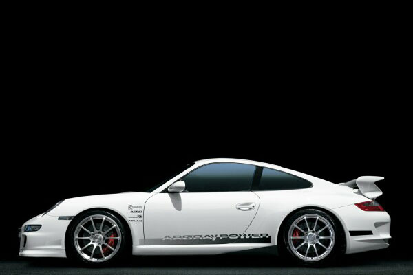

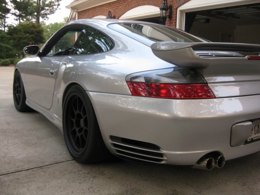

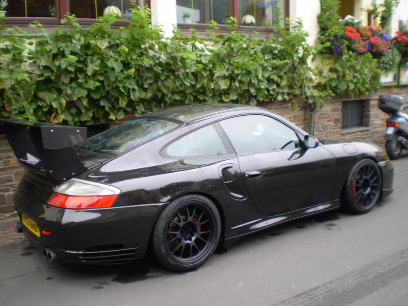

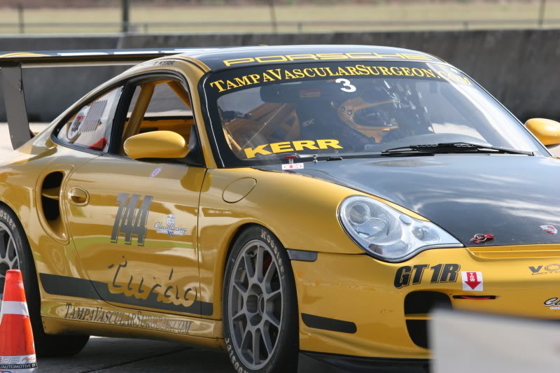

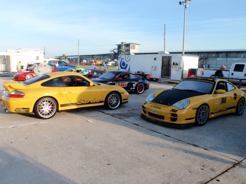

I am running 315's in back on champion RG5's. Dunno if they fit over the Brembos, but they are amazing rims. Light strong, and it took ONE(1) weight to balance the rear 18x11.5 with 315 PS2's on them.
Tom

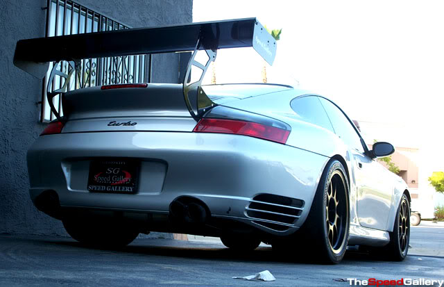

Because of the BBS LM's inner step lip, it's a bit harder to fit Big Brake Setups especially 380mm kits.
I've found that designs like the Advan RZ-DF wheels and Forgestar F14 wheels clear BBK setups with ease! Plus, they're very light - much lighter than those BBS LMs you were considering!

GMG WCGT fit too:
