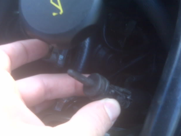

I've noticed my decklid engine fan is NOT turning on after driving, even after a spirited drive. I did confirm today that the fan is working when the car is running, I pulled over (left the car running) and checked it and it as spinning away.
What should I be looking for ? Checked for codes with the Durametric and nothing. Ran fan tests with the Durametric and they all tested fine.
Either something is disconnected or loose, bad temperature probe/sensor ? Was hoping someone could help me locate the sensor/probe. I've looked on the right side of the engine, but I'm not exactly sure what I'm looking for.
Much appreciated.

The fan does not always go on after shutdown. Go for a spirited drive then pull into the garage and leave your car on idle. If it turns on, it is working properly.

I will try that, before the K24/18g's Proto tune, I was running
GIAC on K16's and the fan seemed to go on after every drive (after I parked and came back a few minutes later to check on it).
So if I let the car idle after a spirited drive and the fan comes on, if I promptly turn off the ignition and remove the key, should it continue to run ? I was under the impression it was supposed to do this ?

I believe if you shut the engine off, the fan should continue running.
If not, it is possible that the fan sensor has been programmed out.

After the engine shut down, for 40 minutes the ECU is taking care of the engine compartment temperature. As soon the temp. is reaching 172F it will start and stop to keep it under 172F... So the fan is triggered at 172. Same thing if the engine is running. The temperature sensor is located a bit aft of the recirculation blower on the right side of the engine compartment. May be the sensor is at fault or the plug is corroded. Pic show you what it's looks like... Also some valuable information here:http://www.renntech.org/forums/index..._1#entry160046

that temp sensor is easy to accidently push into the grommet it sits in. possible the grommet is insulating the tip (sensor).

I had a similar concern as even after spirited driving on a 95 degree day, the fan did not kick on after shutting off the engine. My investigation revealed that the sensor was sitting on the serpentine belt (luck me that it didnt get damaged). I have since zip tied it in place and the fan comes on after the ignition is turned off. Does anyone know how to reseat the sensor in the rubber grommet?

For those of you who like technical specs.....
Turbocharged engine purge fan operation:
There are three possible causes for the fan to be activated in a turbocharged 996 models, but the fan only runs at one speed. The causes are:
Ignition on (for longer than one second) or the engine running, the fan will be activated by the fuel pump relay via the booster resistance cable if the cable has detected a build up of heat (by changing his resistance) from the turbocharged engine's exhaust system.
At a coolant temperature of about 105C or 221F or an engine bay temperature of approx 78C or 172F the purge fan will run until engine bay temp drop to about 60C or 140F.
The engine overheat after shut down protection system is activated for a maximum of 40 minutes after the ignition is turned off and if the engine bay temperature is greater than 25C or 77F . If the engine bay temperature rises to or is already at a temperature in excess of 78C or 172C for more than three minutes the engine bay purge fan will be activated. The purge fan will stay running until the engine bay temperature drops below 78C or 172F
This come from the excellent book from Adrian Streather " Porsche 996 the essential companion"
