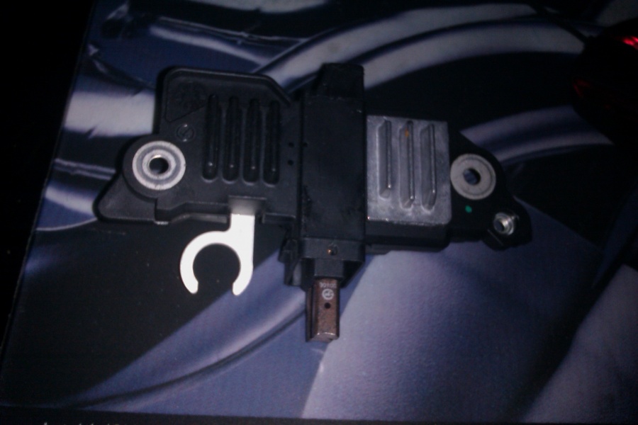

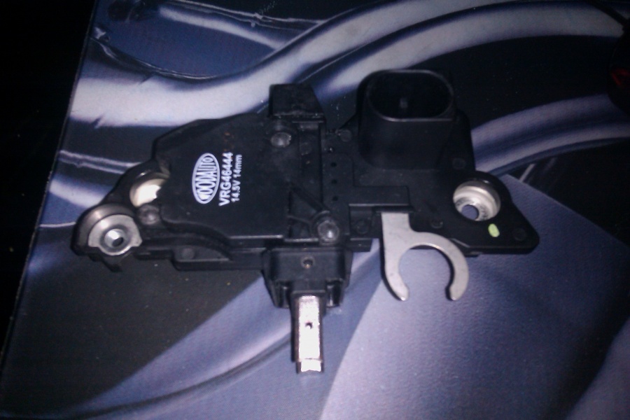

alternator voltage regulator
dealer wouldn't sell it seperately.
Just received mine in the mail. thought it was a bosch part I was ordering but it's a woodauto. 80 years of experience and huge product range. should be reliable. part number is VRG46444 if anyone's interested can search it on their website.
will update if it doesn't work.

Thanks for sharing the part #. Do you know if this can be done w/o removing the alternator from the car?
I just replaced the regulator on my BMW and it worked great. Dealer told me I needed an alternator @ $600. Found a regulator for $40
doesn't look like it, the voltage regulator is located in the rear top side of alternator and there's too much stuff around that area.

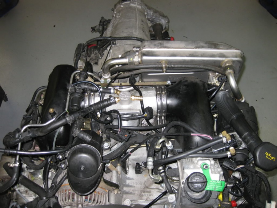

ya already had my alternator out as well as half the motor! Had to rebuild the wire harness for the drivers side knock sensor. Porsche said they have to drop the engine to replace the two wires and $1000 bucks to do it. I said to hell with that pulled off a bunch of boost hoses, air box, alternator, intake plenum etc. Made my own long reach tool out of some round bar and flat stock welded it together and some double sided tape, problem solved $1000 saved and no you don't have to pull the motor to repair the knock sensor. They couldn't believe it, they said I should market the tool but just proves anybody with some free time and minor mechanical abilities can fix anything.

don't want to break any rules. google "woodauto" then search for "VRG46444" There'll be a breakdown for bosch OEM reg. part numbers, this woodauto's reg replaces and list of bosch alt. that it fits. Don't have the bosch reg and alt part numbers anymore but did cross check it before I ordered. it's about 50usd plus 15usd shipping for 2pcs.
if possible to get bosche for cheaper locally, this is the way to go. Wasn't an option for me, unfortunately.

I'm also replacing the voltage regulator on my 02 996. Got bolts out of alternator and I can get it to move slightly up and down but can't get enough room to take it out. What else needs to be loosened/ removed to get alternator fully out to get to the voltage regulator? Please help? I'm anxious to get back on the road

You have to put a screwdriver at pry bar and pry it up until it comes out of the part that the inner most bolt goes through.
