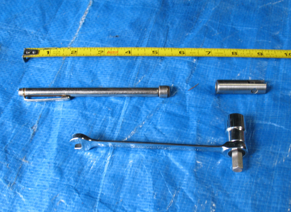

Originally Posted by DERBOOST
Costal...go get a 8mm allen wrench, with a grinder cut off a 1" hunk, then get a 8mm little gearwrench...super easy this way, put the 1" hunk in the nut then slip the gearwrench over it..bam out she comes. Now to bust it loose take the allen other part you still have and put it in the nut,then you use a prybar and a hunk of wood to crack it loose then go to the gearwrench...
I hope the guy who invented gearwrenches is a billionare cause they are amazing.

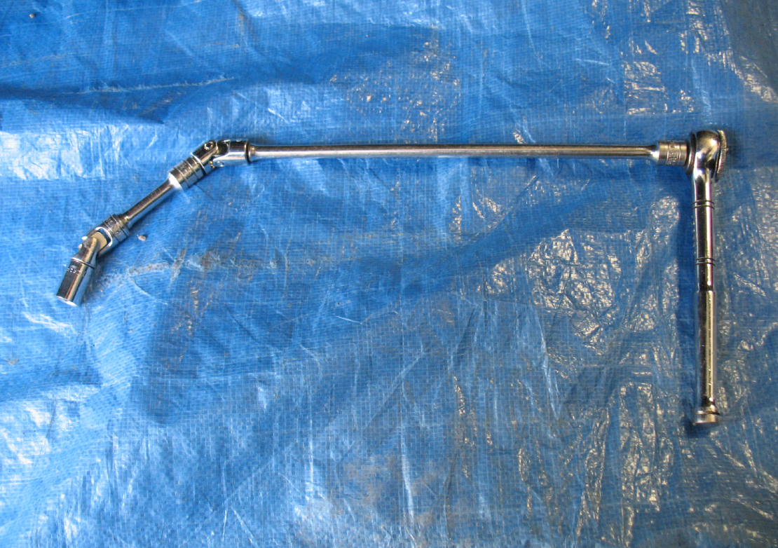

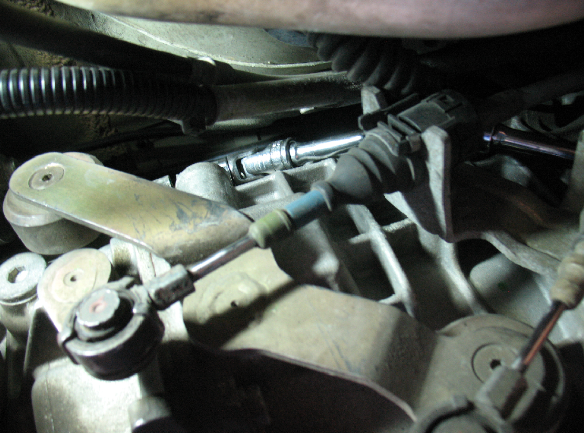

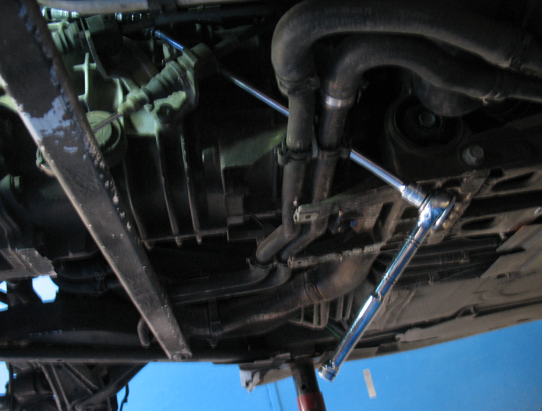

Completed...
Just did the mod with a lot of help from the post of Turbotodd (renntrack) and the numerous suggestions from this forum. I post a couple of pictures to show the angle I took and the tool I have used. Hope this help....
The only comments I can do is the bolt was really tight and the cover was tight all the way until it came off.....
