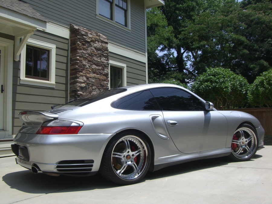

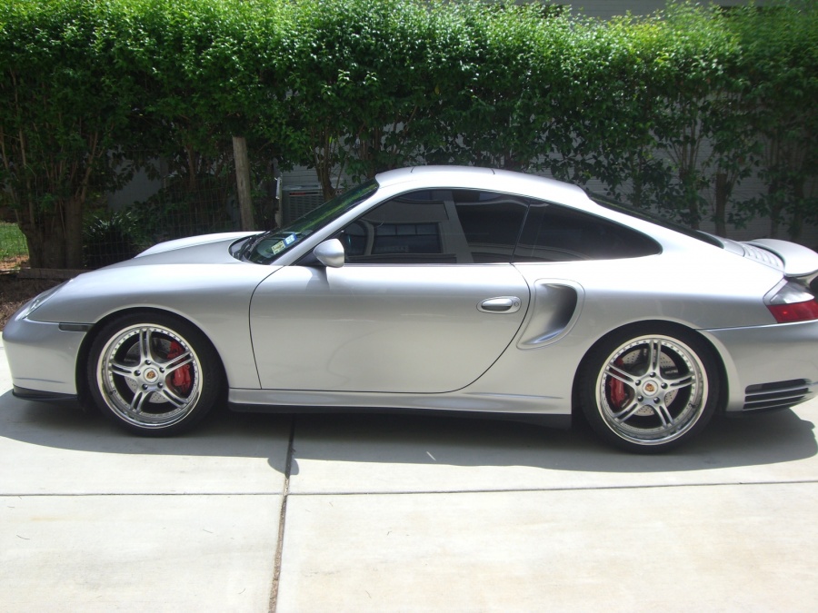

So...first p-car, and I love it! Picked it up in TX...drove it back to NC! Have to say, didnt get bored, awesome drive. Been looking at this forum for a year, and with all the GREAT info on here, was able to find exactly what I want!
So the car...an '01 tt, with <30k miles, progressive springs, Ruf SSK, and wheels (anyone know what kind? Havent figured that out yet...do love them though).

BTW, those rims are crap. They literally will explode if you exceed 120mph for too long, very dangerous. My recommendation is to sell them ASAP. If you could get $500 (with the rubber) you'd be lucky. PM me if you're looking for a sucker to unload them on.

Wheels look like they might be SSR GT3s.
sweet ride dude..
they're knock off of the SSR..I have the same one..still searching for new rims.

Yep, at first glance, looks like SSR GT3's .. had them on my E46 M3 .. bent a few of 'em ... I was made to understand they're a litle soft ... I liked 'em tho
Haha... SSR's in the S32k world stands for "Super Soft Rims"
