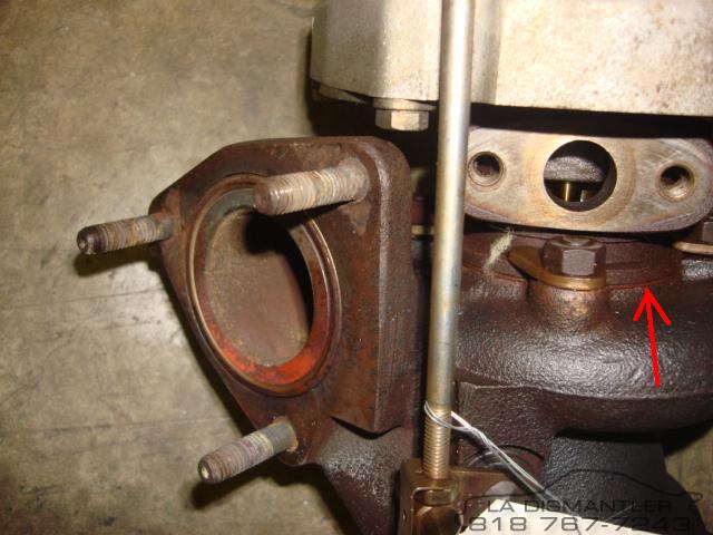

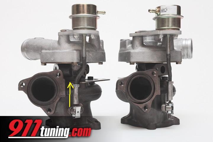

Sorry...I wrote a totally incorrect and actually stupid thing... Obviously there is no direct coupling between comp. and turbine...
I will try to explain through images:
These are not my exact turbos (I have regular K16), but I could not find images of K16's taken on a side view.

Hi Emadelta,
Any leak from that area is not good. It could be just a case that the clamps holding the Turbine Housing to the Bearing Core have worked loose. However it is very important the housing is totally secured to the core. If they work loose then the housing will misaligned with the Turbine wheel and do damage to the wheel Usually just rubbing first leading to very quick catastrophic failure of the Turbo. You must check out both of yours. Could be just a case of tightening the 13mm clamping bolts.
This problem is more common with corroded Turbos, I hope yours are not corroded.
Frank.
