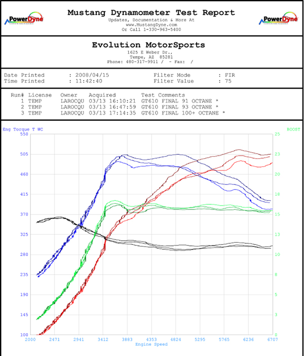

Congrats on the new car. I had this kit after I had a flash+exhaust and yes it is a huge improvement. We are talking over a 1 sec improvement in 60-130 between the old stage 2 and a GT610. To my knowledge, all EVOMS GT610s have the Tial Alpha 28 turbos. You will need to retune to 91 craptane unfortunately. The stock clutch will not last long. I had a stage 1 EVOMS clutch when I had this kit and it was fine. I dont know if car will pass smog in Cali.
I ran a 7.68s 60-130 with this kit and ~180 the TX Mile
Here is a dyno and the 7.68s 60-130:

I have a dyno of 520hp/510tq on 93 with the GT610 (it is somewhere around there). I can try to get you the scans if you like, let me know. I still have a stock clutch and the kit has been on for about 9K miles. All the GT610 kits have Evomsit tuning. I am planning on replacing the clutch when it starts slipping (I would think soon), so plan on that soon for yourself.
