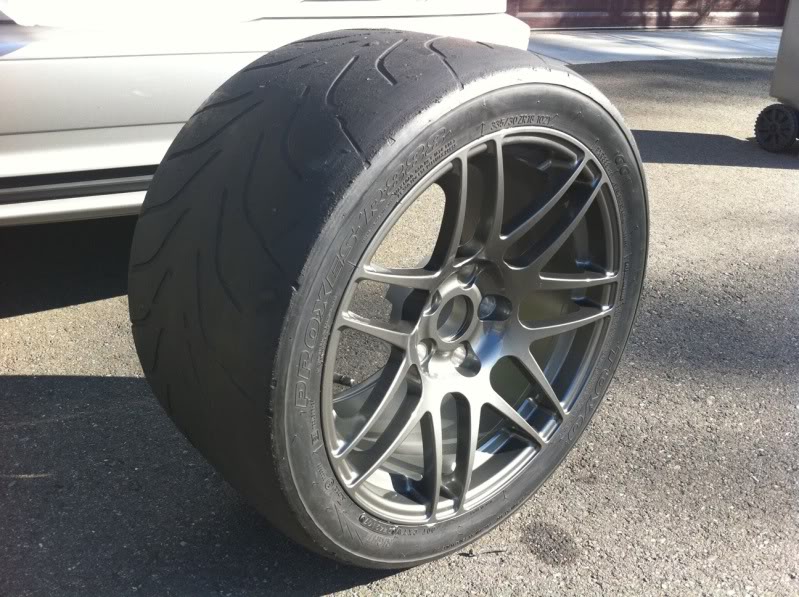

Fitting 335/30/18 Toyo R888 in the rear
In my quest to get better traction I have optioned for a set of the new lightweight Forgestar F14s with some sticky R888 tires 245/335. I am wondering if anyone else has installed this setup and how they modified the inner plastics. I test fitted the rears last night and I see I need to either cut out or reshape the liners. I am worried about the lower IC hose vulnerability to road debris without the liners. And yes, I have the fenders rolled and -1.8 camber in the rear. Any thoughts?
Here are some pics comparing my 19X11" with 315/25 to the new 18X12" with 335/30:

what offsets do you have on your rear rims? Thoughts on spacers to help push out the rims a little? Personally I'm not a fan of spacers.

Can't remember where I read it but one guy said he heated up the fender well material to reshape it. Good luck, those tires are wide. I stuck with the 315's myself.

how's the offset on the wheels. if it's not to agressive I would space them out to be as far out as you can without the tire grabbing the quarter panel and then go to work on the fender liner. heat it up or/and cut. one thing to watch out for is that charge-pipe....dont wanna rub through that.

Take a heat gun to the rear fender liners, where the tires make contact. When hot and pliable, push in the plastic with something like a baseball. Hold that position until the plastic cools and will hold the shape. I moved the lower attachment point, for the drivers side, back about 1". ALSO, Before heating the plastic, bend the fender liner brackets back/inward 3/4" to 1". I actually removed the flimsy bracket on the drivers side, which seems to have the most clearance issues. Camber set for -2.0 all around.

Ahh, thanks Zipppy thats what I was looking for! Ill post pics up when I am done. I am not sure on the offsets of the wheels. I was told they were for a 997tt but will work great on my 996tt.

i have 335 ra1's on my GT2 on 18 x 12 stock wheels with 45mm offsett.
I'm going to heat the inners for a bit more clearance.
