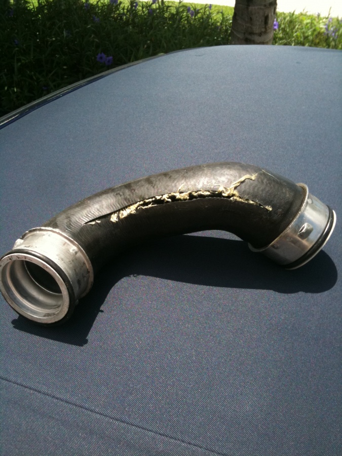

Signed up and went for my 1st two day DE at TWS last weekend. I had a blast, learned some new skills, and pushed the new car a bit on the 1st day. These cars sure are fast!
Day 2 starrted out great, started reeling in the rest of the green group, only to be suprised by the low coolant light alarm and blinking temp gauge. Limped it back to padock with cloud of sticky sweet steam following me. After a cool down I found the passenger side large coolant hose split lengthwise about 3" long.
Car has 35K miles and the hose did not look rotted out, it looked almost like it burst. I'm going to go ahead and change them all now, as I spent the rest of my 2nd track day fixing it so I could drive home.
Anybody else lost one of these large hoses or had similar failure?

Happened to me, but it was in back of the car. Someone else in the thread discussed what you are talking about - I think.

This has been happening to a number of cars lately. Do a search on this and look at all your options. So far so good with my car, knock on wood.

From talking with Kevin at UMM, I am pretty sure these parts are a must to replace and a common failure (although in my case these were not the culprits - I replaced them anyway on his rec.)
996 106 501 74 to superseded part 996 106 501 76
996 106 502 74 to superseded part 997 106 502 00
http://forums.rennlist.com/rennforum...34-post10.html

Yep, blew one last month, coolant light went off just as I was braking and turning into turn 1, almost lost the turn, inexpensive to fix. Apparently a Pentosin leak I had weaken the rubber on the hose and finally blew!

Pentosin does eat hoses.
My hose looked just like that pic.
The "Glued in fitting" failure you guys have seen, is it a glue joint failure or just rubber hose spliting?
Just the hose split, it was weakened by Pentosin leak dripping from the low pressure line above it.
