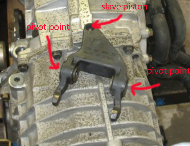

I would like to help but never heard this before.... Of course there is a spring inside the slave that is moving when the clutch pedal is depress. (se pics in red) and this spring is flooded in pentosin oil. I doubt the noise come from inside the slave. But may be from the pressure plate or the fork that is operating the bearing onto the pressure plate.... Difficult to troubleshoot without being under the car while someone is operating the clutch pedal....

could be the dry contact point from slave pushrod to the fork, dry pivot bushings on the fork, pressure plate, etc. hard to tell unless you take it apart and lube everything and recheck but might as well change the clutch while you're there

If you feel like trying something not too easy because of the accessibility but may be useful.... You got a small access on the right side (left looking aft) of the transmission. After the starter is removed there is a rubber cap that give you access to the clutch housing. May be you can lubricate the clutch fork pivot point and the contact point from slave to fork like "pinoy911tt" is mentioning.... But the access is really bad.... And be careful not to spray any oil onto the pressure plate.... The last pic is the fork and the two pivot point (may be the noise come from there) and the slave piston touching point....
Wow, that looks like something I'm not going to be able to tackle myself.
Thanks for the explanation. I'll keep this info for the dealership to look into.

That creaking sound usually happens when the pressure plate is on its way out! I am on my 3rd clutch now and its doing it too. I also spun the clutch hard in 3rd gear 4 weeks ago, just have to get the time to install my triple disc set up.
If the noise sounds like its a spring binding its the p plate. the other points of contact do not get greased and unless there is some surface rust would not make a spring noise or a felt difference in the pedal more of a squeak. If it was rust that would clear up after a few strokes of the clutch.
