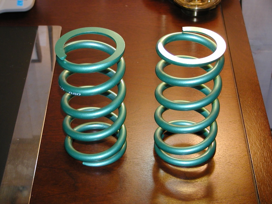

Turns out that I mis-spoke above. I bought 7" springs for the front, but when they were installed, we couldn't get the ride height down where I wanted it. So I ordered 6" springs and that is what is in the car now.
Swift wouldn't take the springs back because they had been installed, even though the car was never actually even driven with them in there. So I have a set of 7" 450 pound springs (Z70-178-080) that I'll make you a good deal on if you want them. Photo below. The part number code means 70 mm ID, 178 mm long, 80 kg/mm. PM me if you're interested.
Jon
