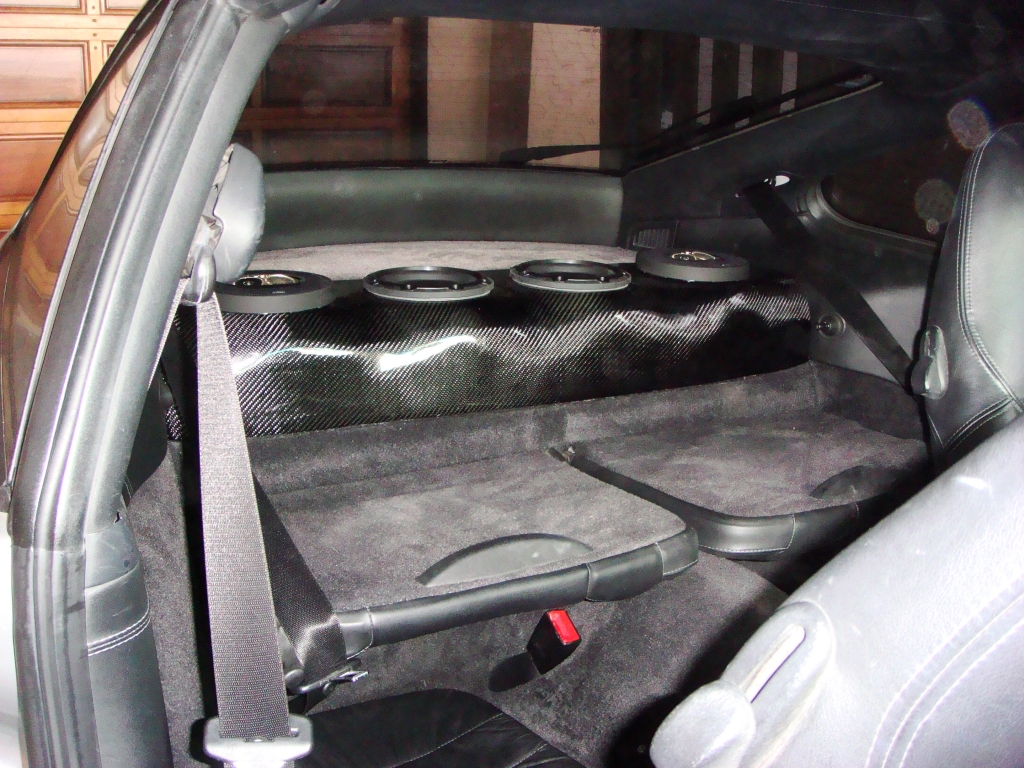

I just built a nice sub box to fill the front part of the shelf behind the back seats and I need to route speaker wires from the AMP in the trunk through the car to the back seats. For those who have already done this - where do you route the wires? I'm thinking over the door would be the easiest, but I'm looking for experience...

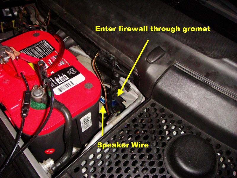

Remove your battery. Behind it is an approx 2.5 inch rubber grommet. It has adhesive-backed foam behind it inside the passenger compartment. If you fish through that grommet, you'll end up right above the gas pedal. run wire under console, under shifter boot and back from there. You don't even need to remove the rear console. Took me 5 minutes to run a wire for a dension install.

There are a series of rubber grommets of various sizes on the firewall. Just pick one and cut/drill thru it, some are thinner than others. Finally seal it up with some silicone.

The firewall isn't the issue - it's the route within the car. Here is a picture of the sub box. I need to get the wires to the right side of the box as you see it here. If I go through the console, there is nothing to hide the wires under to get from the console to the box. Hasn't anyone done this before?

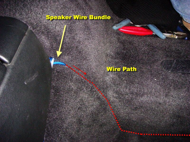

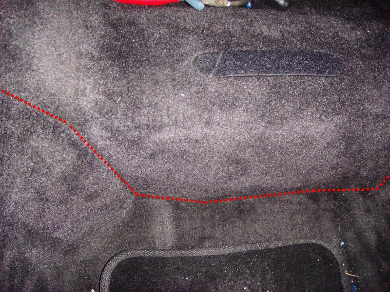

The job's done - here's how I did it...
I thought I would post what I came up with to make this job simpler for the next guy...
The carpet in the 911 is very thick - at least an inch with lots of soundproofing so if you put wires under it, it will not be noticeable. I went though the firewall in the center of the car, under the console, across the rear driver's side seat and up behind the trim on the driver's side. I left the wires visible behind the console for the pictures.

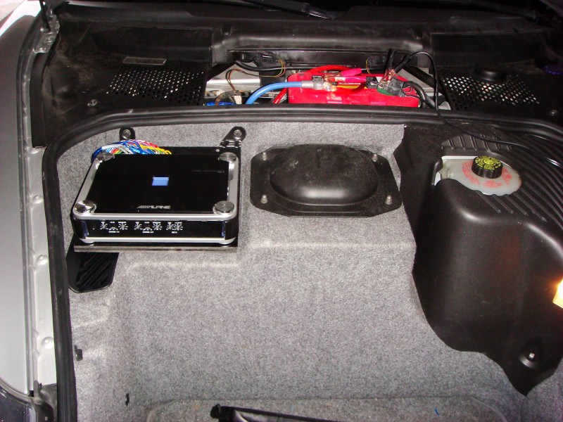

Need old post member to answer what he did
On 12/29/2010 Slider posted pictures of his trunk mounted Alpine amp. Mr. Slider did you fasten screws to the shelf the amp it's on. It is Boeing the gas tank so how did you avoid puncturing the tank. Is that bracket homemade? Purchased? Where?
