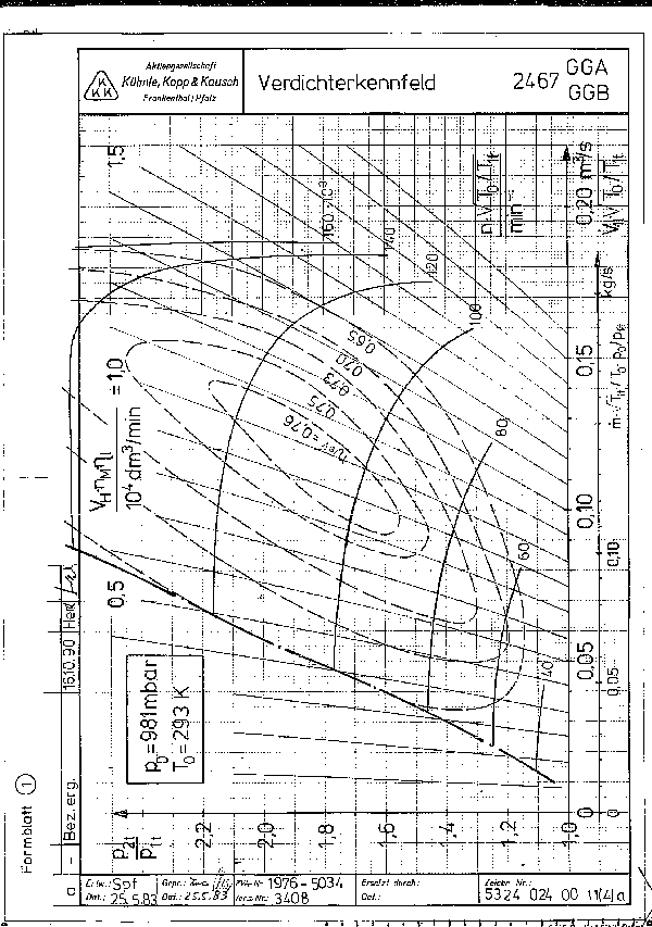

Mmh, 1.2 bar gauge pressure on k16....
here is the comp map:
With 1200 mbar gauge pressure, 981 ambient pressure, you are at 2.22 pressure ratio (more than this actually, because the gauge pressure is measured after piping and IC's, so there would be some additional pressure to add because of the pressure drop).
Assuming a VE of 90%, at 5500rpm the turbos are flowing 360cfm each, which is 0.16 liters/second. This means the turbos are working in the 70% efficiency zone, pumping air at 135°C.....
At 6000 rpm they are flowing 0.175 liters/minute, efficiency is near the 65% zone, with air temp 145°C...
This is with ambient temp of 25°C.
So during winter I would say no problem, but I wouldn't run that much boost during summer on k16's....
Boost gauge could be wrong though..
