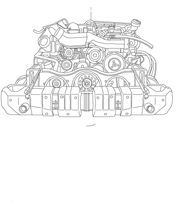

I'll have to look under the car to see how everything is hooked up. I just recall seeing pictures of the whole engine/turbos/exhaust removed as one piece. The PET catalog shows it like that too. The exhaust should be attached via the straps to the engine carrier.... Anyone wanna chime in?

The straps connect to the carrier and it should come down as one piece. Whether or not things will hit, you'll have to watch to be sure...
