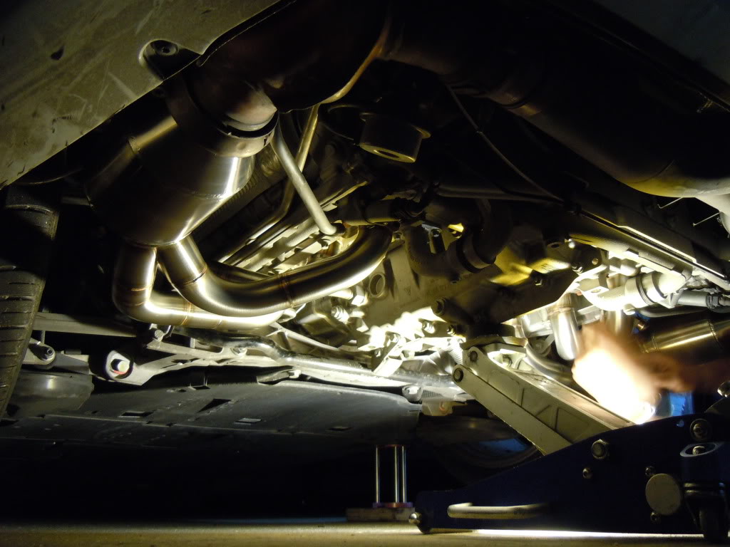

Can you elaborate?
This is from GMG's shop. I'm assuming that they would practice a safe technique.

What I found works well is to have two jacks. Put one under the rear jack pad and lift to obtain clearance to use the second jack under the rear cross member.

Rep Power: 457
[QUOTE=bbywu;3418179]Can you elaborate?
When you are jacking the rear using the engine case you are transferring the whole load of the car by the two rear engine mounts which are not designed for these type of negative loads. People do it, but I wouldn't. I use two low profile jacks with stop pins and jack using the factory jack points. Then I install the pins locking the jacks in position. I leave the jacks in place and in addition I place two jack stands under the rear suspension carrier (as pictured in an earlier post here) as back up. I think a lot of shops use the engine case as it is the quickest method and for them time is money. I seriously doubt a factory Porsche shop uses the engine case to jack the car.
I was never able to find a low profile jack with built in stands low enough to slide under my GT3, so I am forced to use either the jack points or the engine crankcase.
Although the engine mounts are designed to support lateral displacement, I assumed that it would support downward force of the chassis with upward lift of the engine. On many tracks, the car is designed to take significant lateral and vertical forces. Perhaps I should reconsider.
My Rturbo is low also and I can't just slide a jack underneath it unless it's super low. I normally place a 2x6 piece of wood behind each rear wheel and drive up onto it. That gives me enough clearance to stick a jack under there no problem. Takes 30 seconds.... If you think about it, the engine mounts are rubber or in some cases silicone filled and I seriously doubt they were designed for a 2000+lb. vertical load acting in an UPWARD direction. The mounts are designed to absorb mainly lateral loads and a fairly small vertical load (weight of the engine) in downward direction.
Can you elaborate?
Yah I know many of the shops I've been to pull this stunt. It's dumb, lazy or both. I specifically write on the work order, DO NOT LIFT CAR BY ENGINE CASE. If they ignore me and something bad happens, it's going to cost them a new motor. The engine case was never designed to carry the load of the rear of the vehicle. Look how thin the engine tail piece is compared to the jacking plates and suspension sub chassis. If you're going to bend or break something, the last thing you want it to be is the engine case. The picture in the post a few above this is the correct and best location without using a floor lift. The only situation that you have to place a jack under the engine case tail piece is if you're changing out the motor mounts. In this case use a piece of 2x4 cut to the length of the tail piece and place it between the jack cup and engine case to help distribute the load in conjunction with the jack stands at the suspension carrier.
