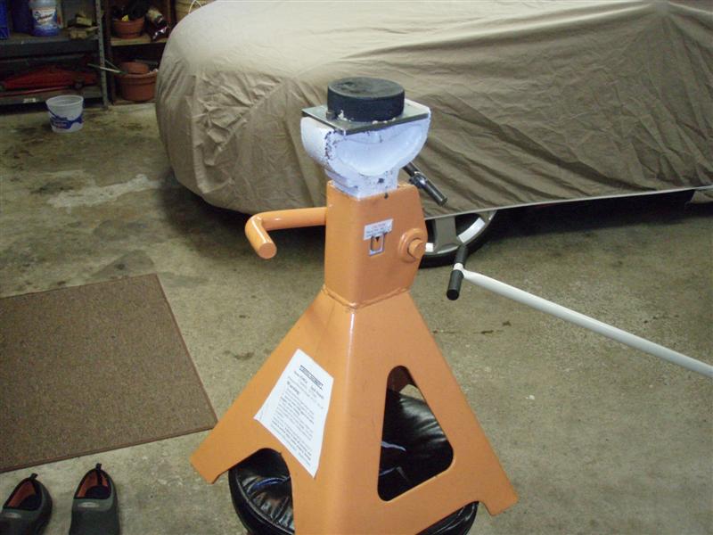

My car is also a hobby car, I'm curious on how you are jacking the car up.

The jack stands I am using are HF 12 ton stands I modified for this purpose. I milled the top flat then drilled and taped a couple of ¼-20 holes. I gorilla glued a hockey puck to some ¼ inch plate and used allen screws to bolt to the stand. I also didn’t trust the gravity locking system with these stands so I miged a nut and made a T handle to lock the stand securely in position.

With the engine lowered down onto a typical height jack(like a harbor freight jack) you need just a hair under 32" from the floor up to the bottom of the rear bumper support for the motor to slide out from under the car(on the jack). that spec usually give you `.5-1" of play room. I use HF jacks as well.
I use those exact jack stands too, except I welded a 3/4" diam x ~1" long pin to the tops of them that fits directly into the holes on the bottom of the jack pads on the chassis. I put a piece of 1/4" thick high density rubber sheet on them(1" hole in the center to clear the pin) to protect the paint of the car. I put the pins in because I have had cars slide on the bare jack stands before when jacking the car up at angle. Little scary.

Rennfab ... Thanks that is exactly the type of info I was hoping for. I'm sure others will benefit from your experiance as well.
I have thought about adding pins to my jack stands but I have never had a problem. Just the thought of it scares the ship out of me. I think I will take the car down and add some pins as it sure cant hurt.

The cycle lifts work great too and I have one here as well. I made that little adaptor piece during one motor drop when I realized that I had loaned the lift out to a friend and didn't feel like waiting to get it back.

If you ever want to pin your stands, you can just go and buy four cheap `5/8"/16mm sized short sockets and just weld them on. No cutting or fussing around getting barstock fabbed to fit.
