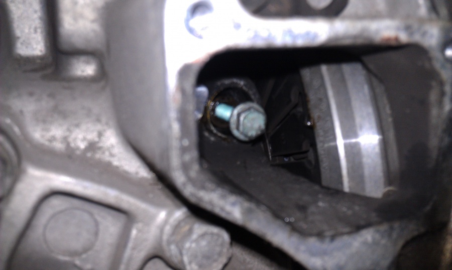

Removed the trans today. super easy with the engine removed. Not going into too much detail here as it has been covered many times on 6speed. Thanks talisman013 for a great write up!
Tip... I didn't have an M6 bolt to remove the pivot shaft. The long bolt that holds the flywheel sensor worked perfect.
I am thinking I should somehow lock the flywheel. Is there a tool for this?
Does it hurt anything to turn the engine?
