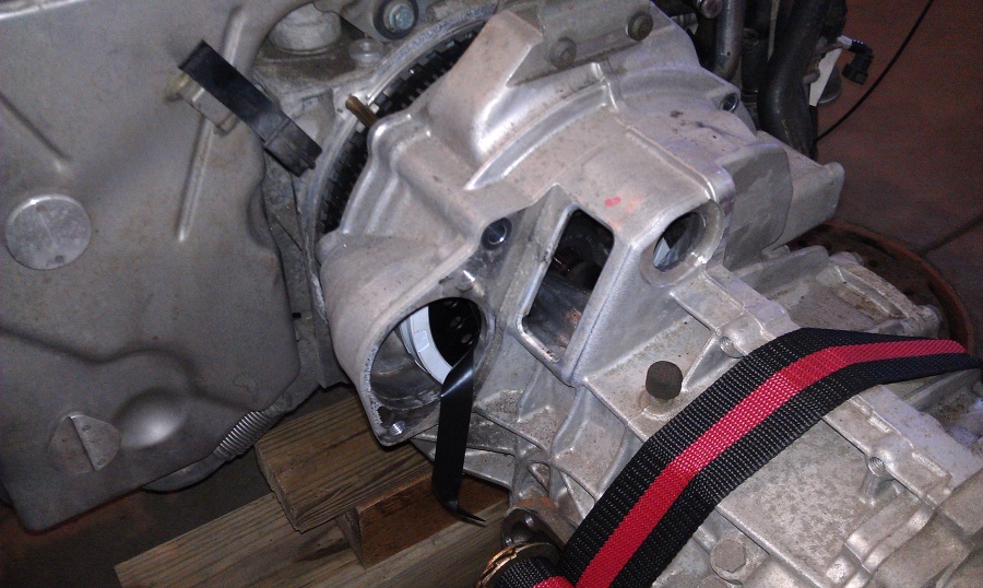

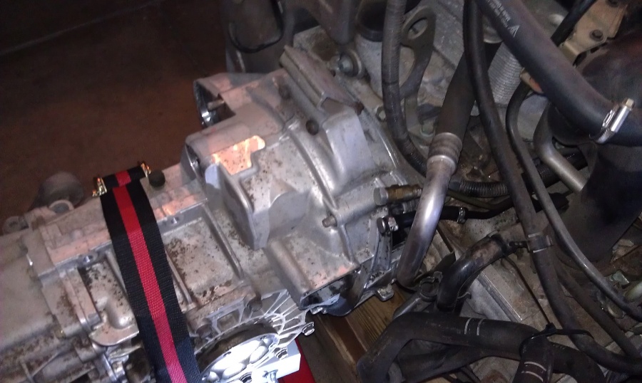

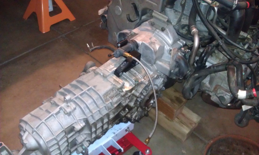

Flywheel, clutch and GT2 slave installed. Everything just slid together using the excellent Talisman03 DIY. I'm really happy I decided to remove the engine for this. I don't think it would be fun doing this under the car.

Are you doing the 997 Transmission mount? I put mine in when I did the GT2 hydro conversion.
Tom
Tom
Yes I am going to the new mount as well as the 997 short shifter.

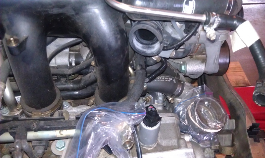

Any chance you could snap some pics of the coolant lines that run over the drivers side of the motor? I've been having this annoying minimal leak since spring. I used a bore scope to see if I could see it and it's hard to tell which is the coolant lines as its all jammed in there. Pressure tested it as well and not a drop in pressure. If you can't I'd understand as well. Just thought I'd ask as its hard to get close pics of this area by looking online.

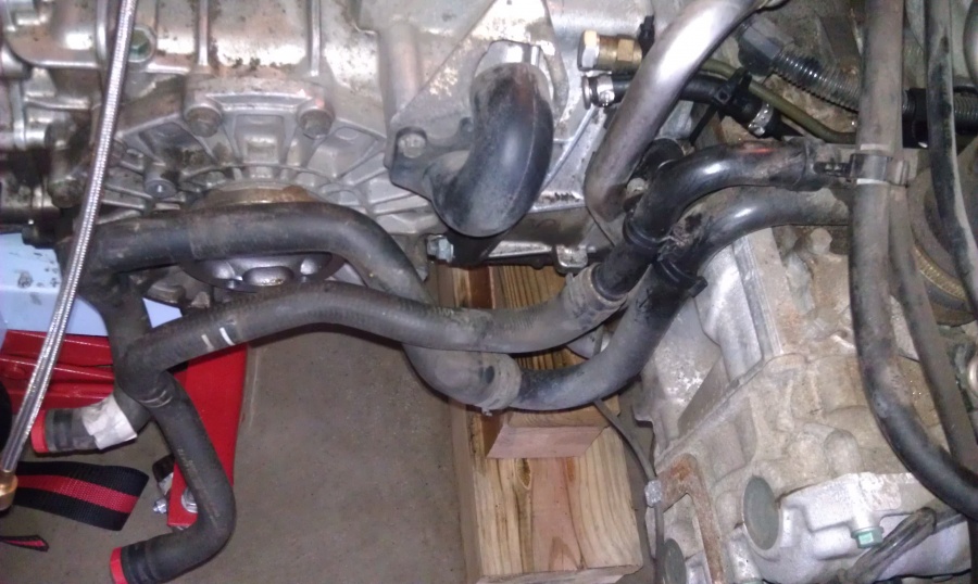

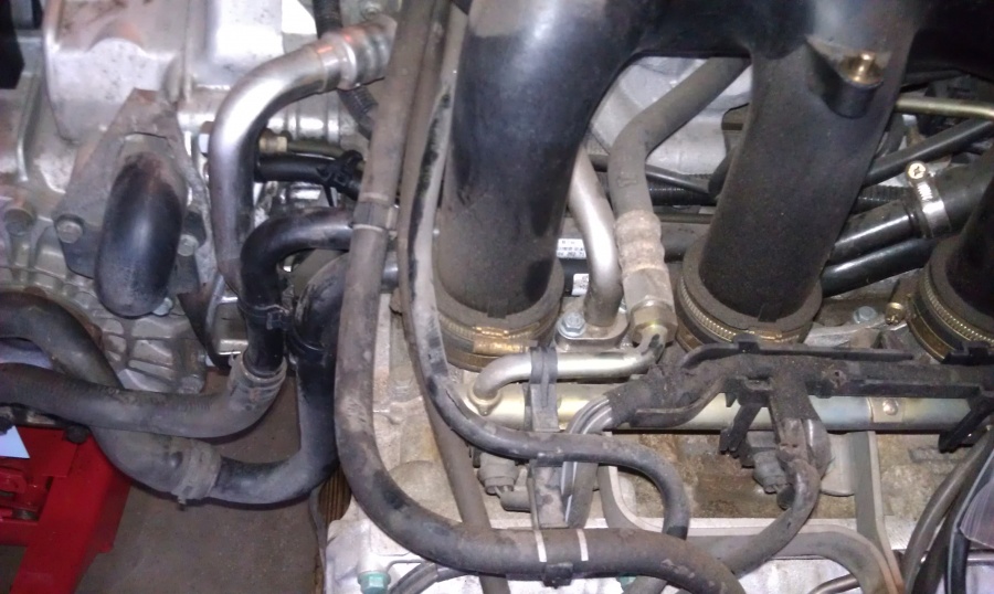

I hope this helps. If you need any more pics just let me know. I have hundreds of em

Todd, thank you for the pics, makes more sense when your not staring into a small hole to tell whats going on. Definetly don't want to drop the motor to fix what would take me two seconds on any other car.
