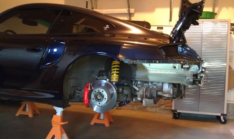

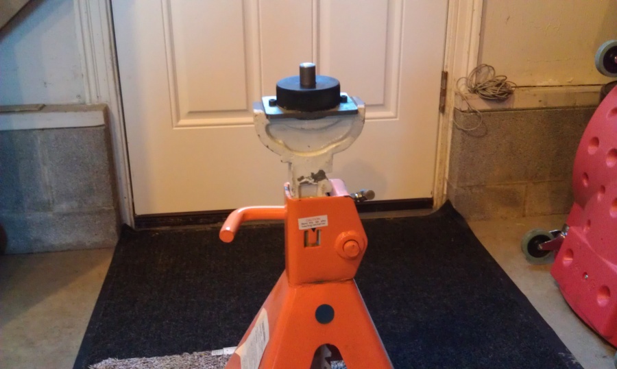

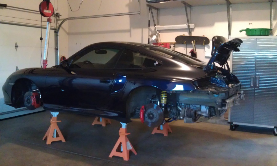

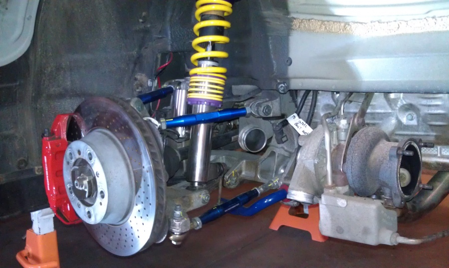

The new and improved jack stands. I just drilled and taped for a .750 bolt. This way I can remove them if needed to work on other cars.
Got the car back up in the air. I took Rennfabs excellent advise and lifted to 32.5 inches from the bottom of the bumper support to the ground. Also have it .250 higher in back than the front.
I did learn one thing. Before you remove or disconnect the battery. Turn your windows down about .250 or you can not open or close the doors with out power.
So far I have the bumper removed as well as the air filter housing. I am taking this slow as I am going to keep this a fun thing.
Pumptech - I will post pictures as things progress.
Someone also asked what turbos I am installing and forgot to answer. They are Alpha 28s.

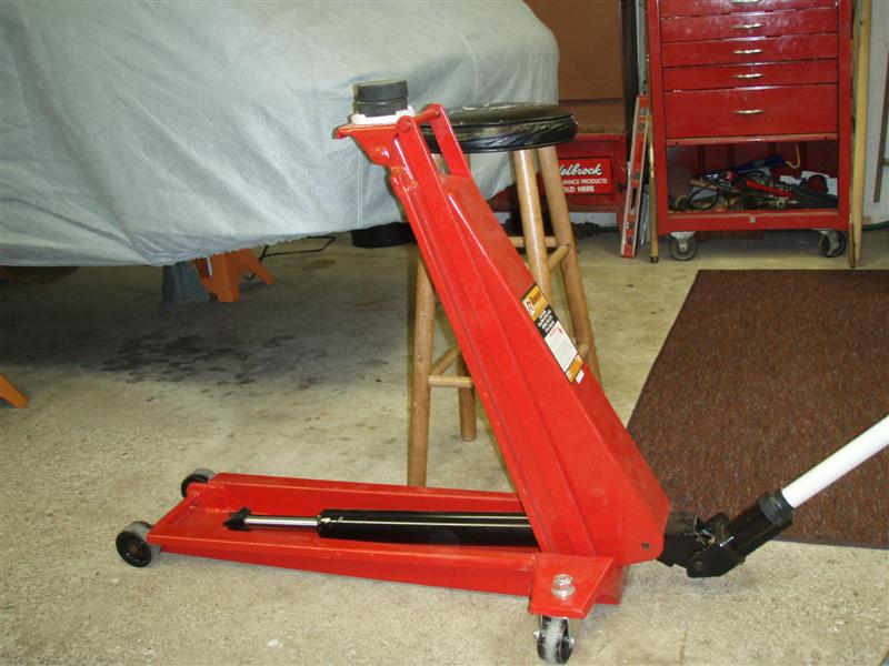

I use two floor jacks to get the car up in the air. I start with a small low profile jack and some smaller jack stands. then move up to a high lift floor jack and larger twelve ton jack stands.

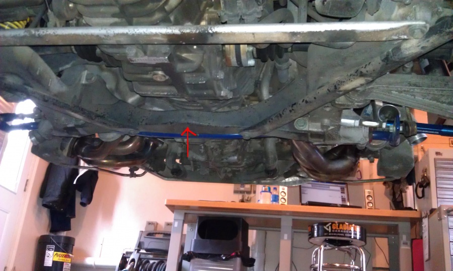

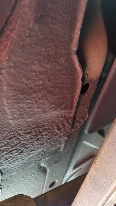

Is there anywhere safe/strong enough to lift at the front besides the jacking points?
Old Nov 26, 2011 | 01:13 PM
  #28
TurboTodd's Avatar
Joined: Nov 2008
Posts: 677
From: Cleveland Ohio
Rep Power: 67
TurboTodd has a reputation beyond reputeTurboTodd has a reputation beyond reputeTurboTodd has a reputation beyond reputeTurboTodd has a reputation beyond reputeTurboTodd has a reputation beyond reputeTurboTodd has a reputation beyond reputeTurboTodd has a reputation beyond reputeTurboTodd has a reputation beyond reputeTurboTodd has a reputation beyond reputeTurboTodd has a reputation beyond reputeTurboTodd has a reputation beyond repute
another good spot in front. you normally have to get the car in the air and wheels off before you can get to it
Old Nov 26, 2011 | 02:47 PM
  #29
Danyol's Avatar
Joined: Nov 2007
Posts: 448
From: AZ
Rep Power: 51
Danyol has a brilliant futureDanyol has a brilliant futureDanyol has a brilliant futureDanyol has a brilliant futureDanyol has a brilliant futureDanyol has a brilliant futureDanyol has a brilliant futureDanyol has a brilliant futureDanyol has a brilliant futureDanyol has a brilliant futureDanyol has a brilliant future
Thanks Todd; looks to me like a separate plate welded over a box section that area? it's all covered with the under sealant I think that's what you're referring to.
Old Nov 26, 2011 | 02:56 PM
  #30
TurboTodd's Avatar
Joined: Nov 2008
Posts: 677
Rep Power: 67
thats the spot.
