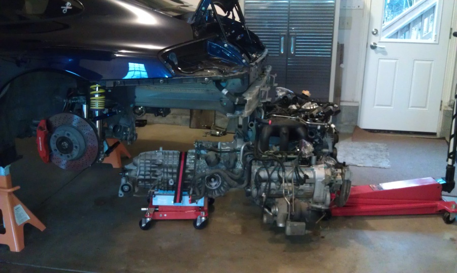

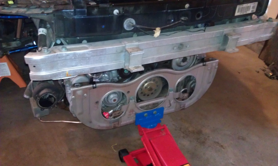

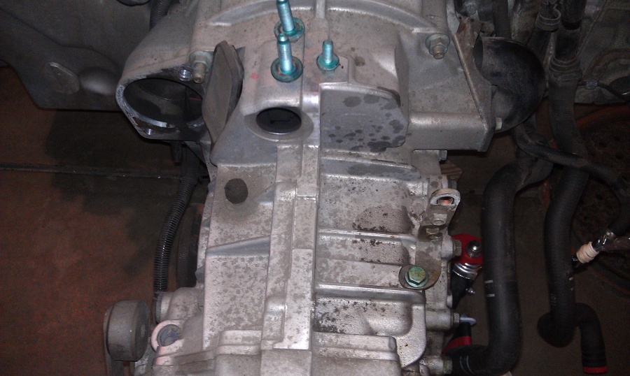

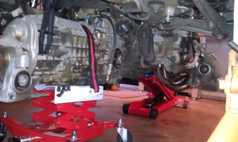

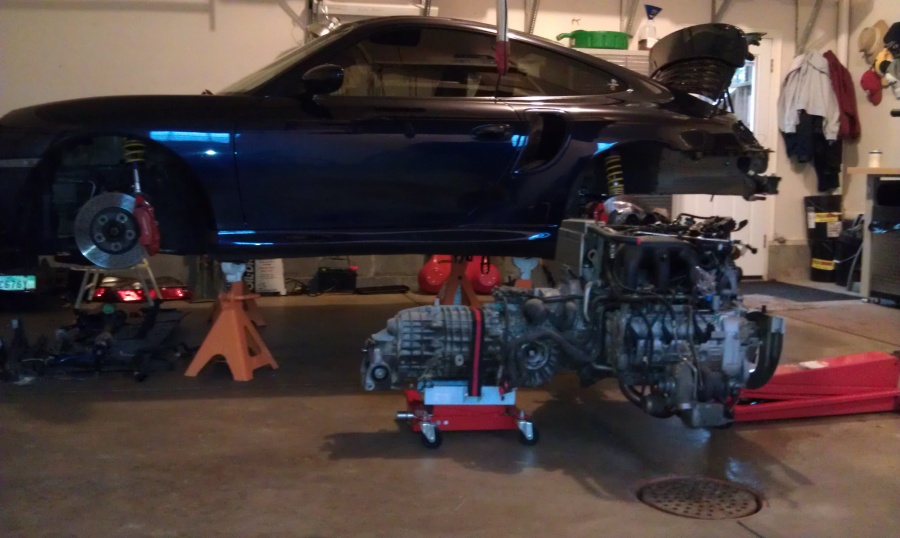

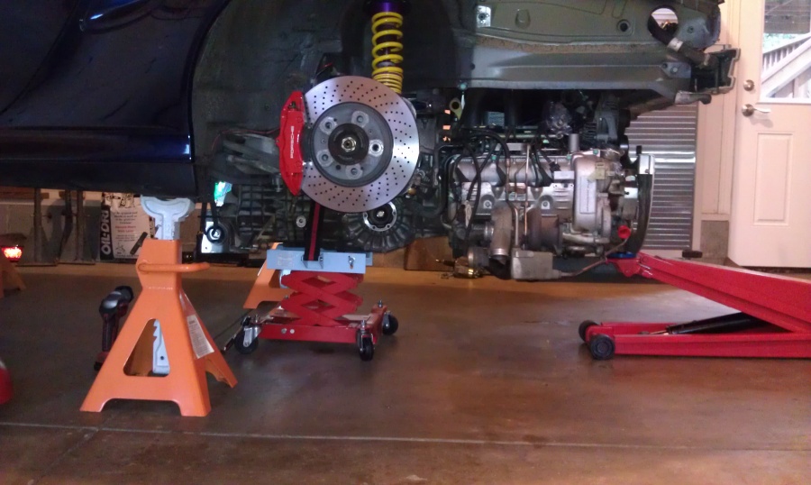

Success !!
The engine drop was a lot easyer than I thought. Everything went very smoothly. To be honest I really enjoyed the process. Nothing like working on your own hot rod.
A big THANKS to Rennfab. His advise really helped the drop go with out a hitch.
I jotted down the order of things that were disassembled. I am not saying this is the best or only way. Just the way it worked for me.
Put car up on jack stands. Starting car height is 22” from bottom of engine to floor.
Car height is 32.5 inches from bottom of bumper support to the floor.
Open doors and run window down .250. Leave doors open until battery is disconnected.
Disconnect battery
Remove boost hoses from Y pipe
Remove MAF wires from left side of air filter housing
Unplug MAF
Air filter housing
Tail lights
Rear bumper
Rear inter fender wells
Exhaust
Exhaust heat shroud
Cat bypass pipes with 02 sensors intact
Turbo heat shroud
Turbo intake boost hose both sides
Intercoolers
Belly pans
Diagonal braces
Rear sway bar
Suspension angle switch and arm
Front driveshaft shroud
Front driveshaft
Reverse light switch on trans
Shifter cables
Drive shaft couplings
Main cross member
Starter cables
Engine ground cable
Clamp heater and main coolant hoses
Drain Coolant
Lower water pump hose, clamped
Left main coolant hose, plugged
Right main coolant hose, plugged
Upper coolant reservoir bleed hose, clamp
Clutch slave line under car
Power steering pump lines
Y pipe
A/C lines
Two millspec connectors
Square connector by millspecs
EVAP hoses above inlet pipe
Disconnect all bolts and hoses from inlet pipe and tie off
Fuel lines
Heater hose bracket on trans above left half shaft
Lower starter bolt
Trans bolts
Lower and remove top starter bolt and starter
Once past the engine mount studs remove engine mounts
Lower engine trans assembly

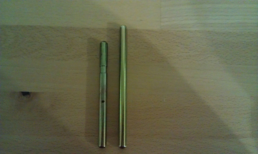

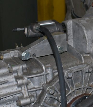

What a great day!! I removed that #^#@*&!! power clutch slave. I have always had burning hate for that set up. I am glad it is gone forever.
I compared the OEM slave rod with the one from the evoms kit. The rod on the left is OEM and on the right evoms. Clearly the evoms rod is longer.
