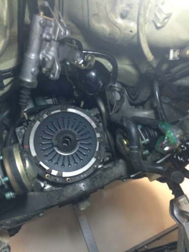

Originally Posted by BMiller33
Caught the sissy hyd slave line and started leaking pentosin but gearbox is finally out. Time to regroup, clean parts, and get on with the program.
Note to others, this isn't trivial and I've built race cars from the ground up. RECOMMEND dropping the motor (and I'm not even to install yet).
Attachment 483129
Done clutches at the track on a BMW 2002 Tii on jack stands and on my back. Never on a Porsche. Has anyone done this using a QuickJack?

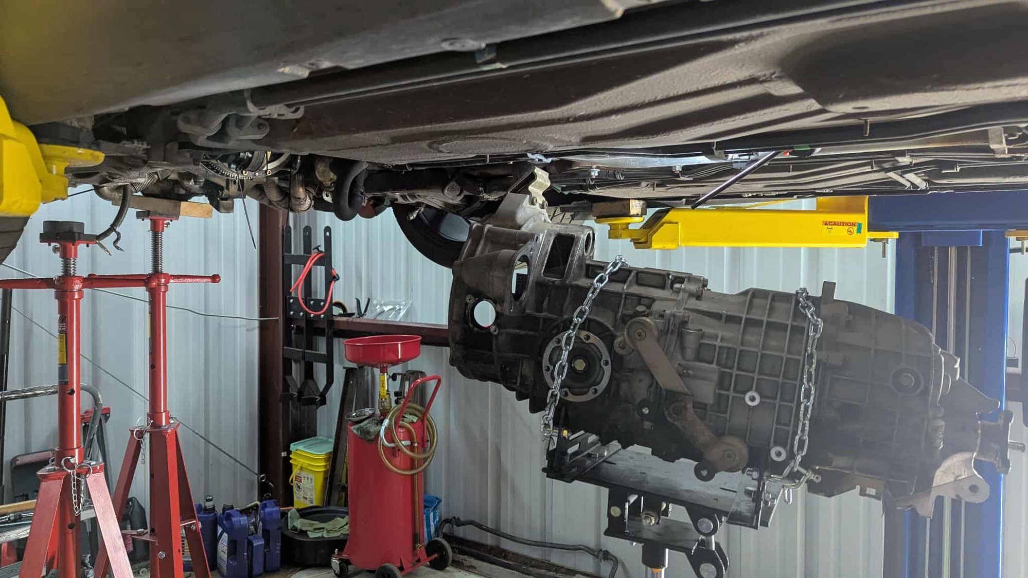

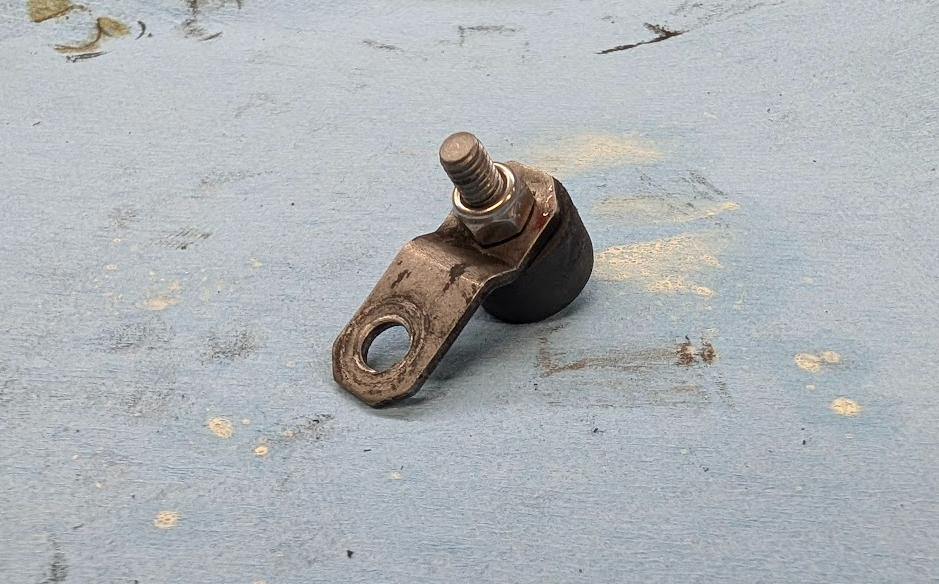

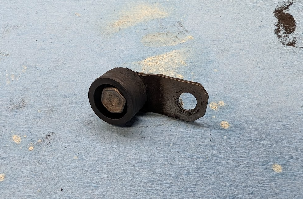

Couldn't get the selector bushing and sleeves quick enough and after changing the gear oil, might have been overfilled a bit. The weep is so minor (never a drip on the groun) that between everything decided to just press.
I modded the pivot shaft cap as it's a ridiculous game to play if/when I ever get in there in there again. Added an M6x15 flange bolt and locknut. Infinitely easier to install or remove.
Got her buttoned up and everything is gravy.
