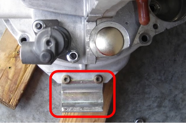

Isn't there a hook at the,top of the transaxle designed to help in a crash? Could that be hanging it up?
Reply
Nov 16, 2016 | 07:56 AM
  #124
ok my mistake thought you were installing. check the lifting hook. also the pass side upper stud if removed helps in tilting the trans. its longer than the others double nut it and back it out
Reply
Nov 16, 2016 | 10:18 AM
  #125
Stupid hook....I'll remove it tonight.

Quote: Stupid hook....I'll remove it tonight.
Might want to keep it. It forces the transmission under the car and stops the transmission from entering the cabin in a severe rear end collision.
Reply
Nov 16, 2016 | 01:34 PM
  #127
Quote: Might want to keep it. It forces the transmission under the car and stops the transmission from entering the cabin in a severe rear end collision.
Just for gearbox removal. I plan to reinstall it. Thx

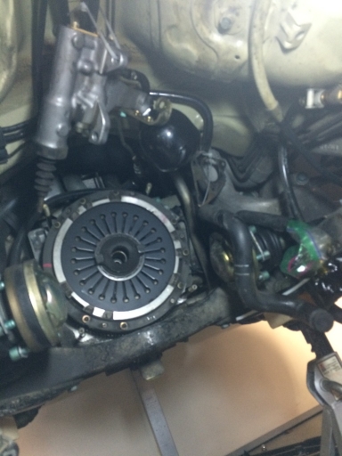

Caught the sissy hyd slave line and started leaking pentosin but gearbox is finally out. Time to regroup, clean parts, and get on with the program.
Note to others, this isn't trivial and I've built race cars from the ground up. RECOMMEND dropping the motor (and I'm not even to install yet).

Quote: Caught the sissy hyd slave line and started leaking pentosin but gearbox is finally out. Time to regroup, clean parts, and get on with the program.
Buggered up line is the best reason for the gt2 slave conversion. And fwiw your about 4 hrs from dropping the motor. Do it now before the real fun begins!! Its super easy with the trans already out

Quote: Note to others, this isn't trivial and I've built race cars from the ground up. RECOMMEND dropping the motor (and I'm not even to install yet).
Thanks, for the intel ... I guess I'll also be pinning lines, when I do my clutch.
Reply
Nov 18, 2016 | 01:22 PM
  #131
Quote: Thanks, for the intel ... I guess I'll also be pinning lines, when I do my clutch.
repalce the water pump as well and any and all rubber hoses and tie wrap every vacuum and boost line you can find. SO much easier with the motor out!
