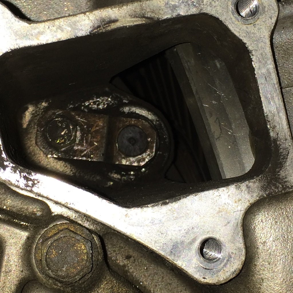

Clutch pivot fork removal....GRRR
So the small rubber piece on the right is removed w/ needle nose vice grips which exposes the 6mm female thread?

Yeah undo the 10mm bolt holding the plastic button down and try grip it with some pliers but they get real tight, i drilled a hole in my button and left a length of thread out of the shaft so you just undo the tab and pull.

that plug has already been drilled for a 6mm bolt. get a 6mm x 100mm bolt and screw it into the end. THEN unbolt the 10mm bolt and pull on the 6mm bolt and all of it should pop out. on reinstall use a rubber oring on the 10mm bolt so you dont drop it in the bellhousing.

I'm still confused. First is the rubber insert on the right, then 6mm bolt thread into the right then remove 10mm bolt on left?

That plastic plug can be stuck in there. I ended up melting a hole in it and then using a hook to pull it out.
I can't get the black plug out

its likely stuck in there. it has no threads so it can be a pain. its hard to get your fingers in there to get the 10 mm bolt out without dropping it so thats why i suggest you get the 6mm onto the black plg then remove the 10mm bolt and pull it all out together. sometimes a hook is needed to grab the plug or vice grips or whatever you can get in there. im guessing the trans is still in the car? meaning your leaving the engine in?

Yes engine in, lowered about an inch and tranny front dropped 4-5". I am going to try to pick it out, maybe poke a hole in the center. If it drops I don't care I'm separating it anyway. There is just no room to work. Thanks for all the tips.
