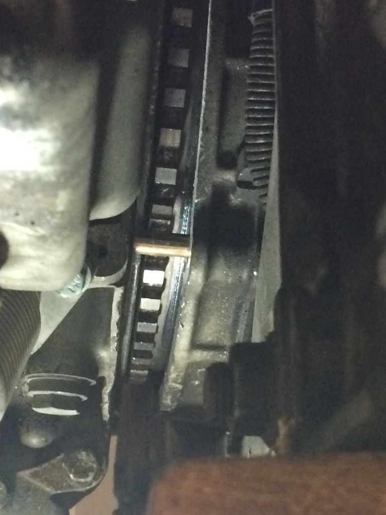

Slave unhooked, starter out, front cross brace unhooked, fork pivot removed, engine lowered an inch, can't get more than about an inch of separation (full ring gear teeth exposed). Tips? Is it all alignment? Been shaking, pulling, rejacking, etc.
mostly alignment. you have to lower the trans enough to clear the front mount bolts. so the engine has to tilt down that far as well. sway bar will likely be in the way. need to remove it. if the trans jack has adjustment use that as well and a small pry bar to encourage the trans to slide out from the clutch and clutch fork
support the engine and loosen the motor mount bolts until theres just a few threads showing on the bolt. lower the engine down to the nuts. keep it supported

This is as far as I can get it; spent numerous hours on it. Time for plan B; drop the engine
