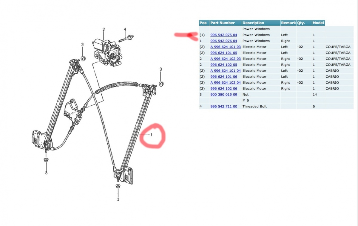

My 2001 C4 has the window issue you described... Makes a slight grinding noise then opens about 4 inches when you shut the driver side door. Any idea what that might indicate is needing repair?
Old Jun 23, 2013 | 02:56 PM
jpflip's Avatar
Joined: Mar 2008
Posts: 2,807
From: Montreal Canada
Rep Power: 268
jpflip Is a GOD !jpflip Is a GOD !jpflip Is a GOD !jpflip Is a GOD !jpflip Is a GOD !jpflip Is a GOD !jpflip Is a GOD !jpflip Is a GOD !jpflip Is a GOD !jpflip Is a GOD !jpflip Is a GOD !
It can be the window regulator, item #1 on the picture. Shop around I have found one for $125.00 on Ebay and it was perfect... Included a very good DIY from smistry007!!!
