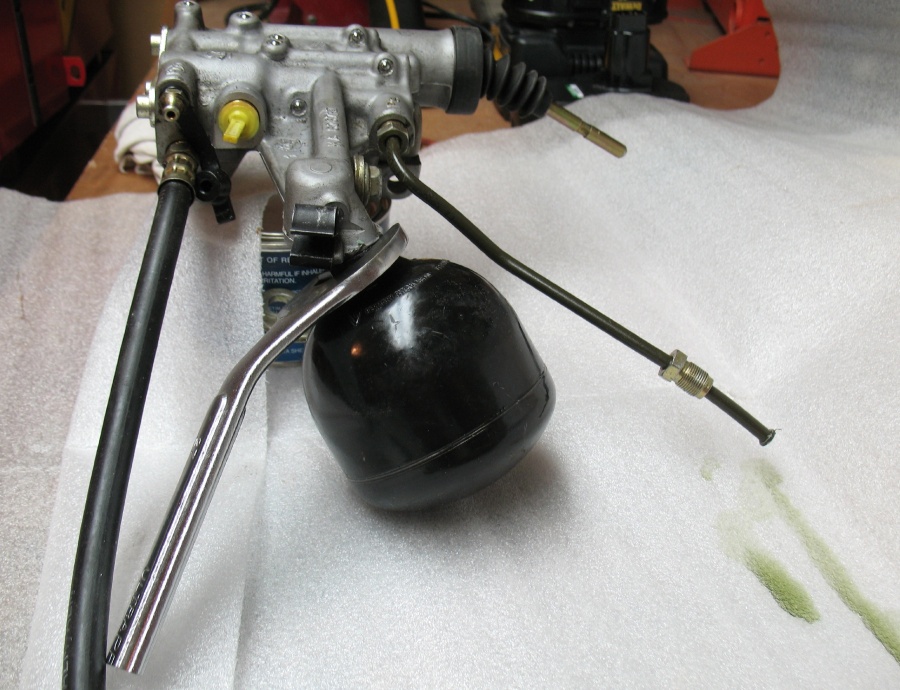

Here's a pic from Danyol's very helpful DIY accumulator write-up:

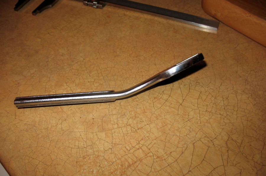

That's a picture of mine. Look at the bend I did to facilitate the job.... Also I had to shave it down to .250 (1/4").

thanks. I'll take the wrench to a local machine shop to make the modifications.

jpflip,
Do you think this will work:
27mm open wrench, 6.35 mm thick head (0.25 inches) with overall length 174mm (6.85 inches). I could angle it like you did with a propane torch.
Old May 23, 2011 | 08:27 PM
jpflip's Avatar
Joined: Mar 2008
Posts: 2,807
From: Montreal Canada
Rep Power: 268
jpflip Is a GOD !jpflip Is a GOD !jpflip Is a GOD !jpflip Is a GOD !jpflip Is a GOD !jpflip Is a GOD !jpflip Is a GOD !jpflip Is a GOD !jpflip Is a GOD !jpflip Is a GOD !jpflip Is a GOD !
Yes!!!!! Good find!

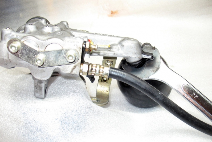

I took a picture of a spare slave and accumulator, You will see exactly the space you have to work with. Hope this help. But I have to admit the wrench you have found is going to be perfect!
