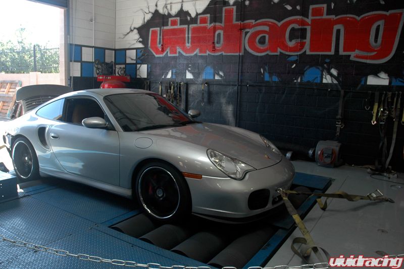

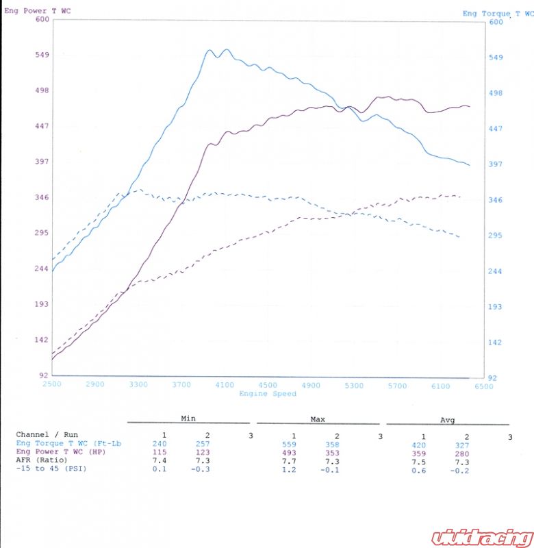

91 octane, tiptronic, 1.3bar, all the bolt-ons, K16/16G with 5bar, Mustang Dyno. 500awhp/560ft/lbs of torque. That is gobs on our Dyno for a basic upgrade. http://www.vividracing.com/blog/gall...94&gallery=495 Eitherway - Markski said it best, listen to the customer, give your advice, here his wants, find a solution. Plus hands down proven time and time again, has some of the fastest cars.
