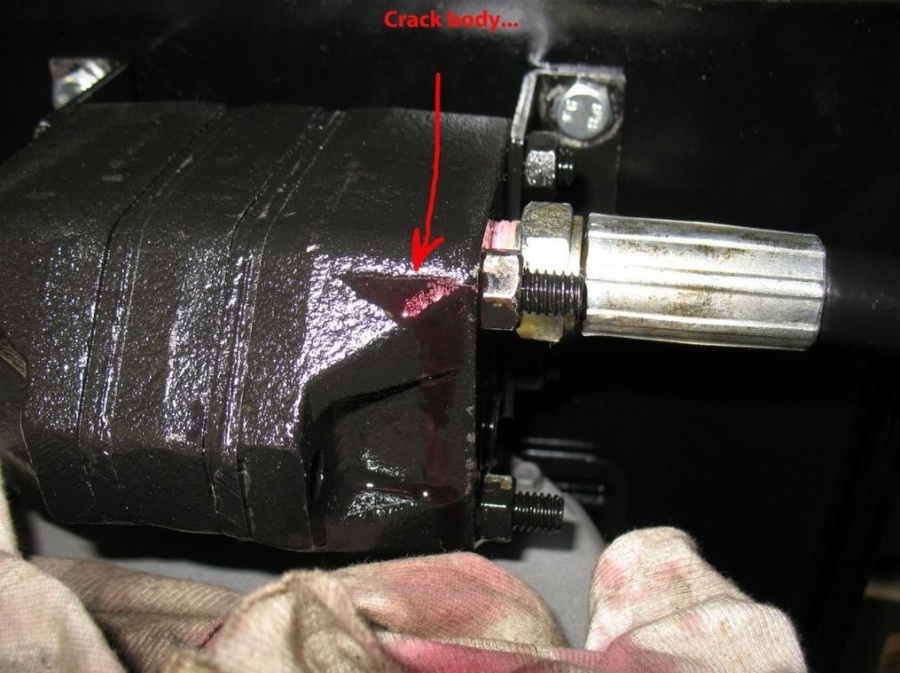

New fix but another problem....
I've receive the new fittings. Better quality, stronger spring and made by Dixon. Note: this new modification provided you with only two quick disconnect fittings and the attachments on the flow divider are now fix!
But I am facing another problem. After the installation of the new fittings on the flow divider, I discover a crack on the body of the valve. I immediately contacted Danmar and within 3 hours received a phone call from a nice gentleman, Gabe (the same one that call me for the fittings failure) and he is sending me a new valve. The over torque fittings possibilities cannot be a factor in the cracked body according to the Danmar rep.
The after sale service is pretty good but I'm still waiting to get a good working tool ;-) Hope yours are working fine, J.P.

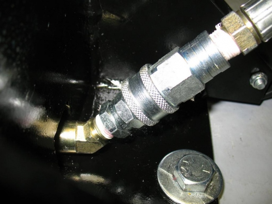

Glad to hear they were helpful! I have a leak coming from my body and the place where the hose attaches to the body. I replaced the teflon tape and still get leaks... I will call them soon.
Attachment 161291
Attachment 161292
Attachment 161293

Hard to say where it is coming from. May be coming from the junction of the body. Anyway don't forget to submit those pictures when you contact the service department. I hope you will get good result with the them.

Do not use teflon tape on oil.. Use a sealant meant for oil..
