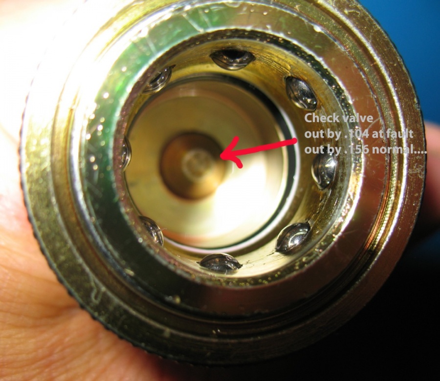

Scary adventure!!!!!! Went full up with the Porsche to see the ceiling clearance after relocating the garage door opener and......Left side post refuse to come down!!!
OOOOOHHHHH MYYYYYYY GOD!!!! My car is lower on the right by about 4 inches and I can go up but not down!!!!!! Decided to lower it with the bleed screw to the upper lock pin hole and put the pins in and release the pressure to rest on the pins........ Now what to do..... Went up again just enough to release the pressure on the pins and strange both sides went down together OUF!!!!!!!
After several attempts I discover one of my hose quick release was at fault. I simply switch the hoses and the problem switch sides....
Every time I had a car on the jack (weight required to repeat the snag because when empty the jack operate properly) and every time I press the handle to lower it, the side with the faulty hose refuse to lower. And I realized the hose stay pressurized!
Did a little bit of measuring and the good check valve quick release adaptor pin is protruding by .156" and the one at fault is only .104" . Probably not sticking out enough and when back pressure applied by the weight of the car it closes due to insufficient opening....
I am now waiting for Danmar to see if they will replace this faulty adaptor....
Now I need a beer.....J.P.
Added a picture of my little garage with new floor and new toy, the Maxjax.... Also the adaptor at fault....

I got a call from Dannmar. I was ask if the quick connectors were gold in color , I said yes. And the support rep. told me that they are aware of a problem with these connectors and they are sending me a different set-up. Only two quick connectors , female and male for the post . And now two "fix" fittings to plug the hoses permanently to the flow divider.... We can say that Dannmar support department is efficient!
