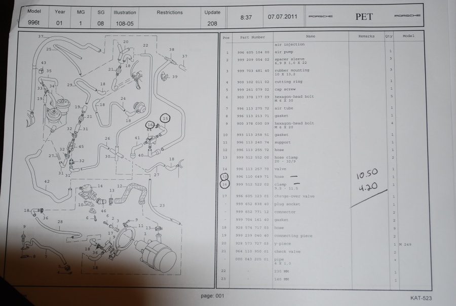

I recently put an EPL tune on my 2001 Tip and also Bosch 710N diverters. Car ran great until last week I had a CEL come on. Two codes came up: P0234 (overboost) and P1133 (02 Sensing...). Took it to an indy repair facility and they performed a boost leak test. Found a split hose from a 'cycle valve'. Hose was replaced Friday and codes reset. Car ran great Friday afternoon, Saturday and again this AM. No WOT runs, just having some fun at 1.0 bar once in a while. On my way home from a show this AM the lights came on again and car won't go past .4 or .5 bar!! Any suggestions?
Thanks in advance for your input.

One more bit of information. The hose that split last week was 15, so that was replaced. I wonder if a malfunctioning item could be causing this. Not sure what the number 44 valve, the description just says 'cycle valve'.
Thats your N75 valve. Certainly a reason why you might be over boosting. The wastegate actuators would not have been getting the correct pressure to shut them down when the boost has reached its design limit. Sorry for constantly asking , but, What codes do you get now the pipe is fixed.
