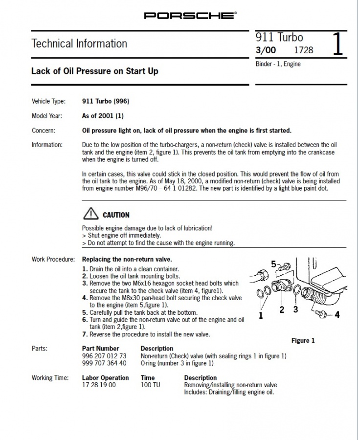

Yes it is back. On my last oil change i have switch from Mobil 0W40 to Castrol syntec 5W40. There was no more lack of oil pressure on start until last week....Did around 500 miles with this new oil and the growling is now there at every cold start.. The tsb 1728 was done twice to be sure this valve was not at fault but no success......Really discouraging....
http://www.youtube.com/watch?v=dyWxfZ_MGBs
http://www.youtube.com/watch?v=NJpN0n2F57o

According to the TSB, the valve is designed to close upon engine shut down to prevent the oil tank from emptying into the crankcase. I'm assuming in normal operation the valve opens when the engine is running. If the valve failed in the closed position then oil would stay trapped in the oil tank and thus starve the engine of oil (hence the warning to not leave the engine running while trouble shooting). If you look at your second video, the valve must be opening properly since you are getting oil pressure within a second or so of engine rotation. I don't believe you will see oil pressure rise any quicker than what your seeing. The noise you hear initially is probably that of a dry engine before oil pressure builds up since most of the oil has drained off the internals due to sitting for a few days.
