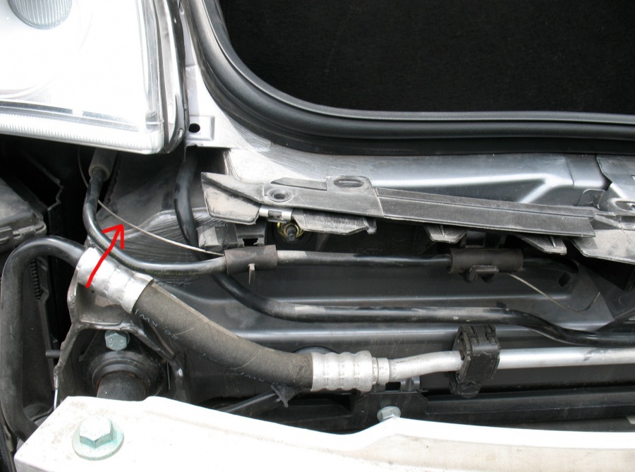

Or found the hidden unlatch cable....Right wheel well under the plastic liner....On the picture a view of what the cable looks like...

Tried the wire which was a pain to find and still couldn't yank it to pop the hood so ended up trying the fusebox trick wich worked like a charm. Wish I had tried that option first!
