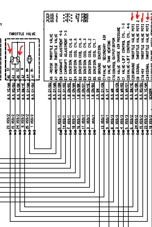

To answer your question Steve, there is 2 position sensors (potentiometers) for the throttle valve located within the throttle body. I am not sure if they can be replace individually. (see attach wiring diagram)

Recently had the "code errors" for the potentiometer and throttle position sensor light. When this happens, the car goes into a "protective state" and won't allow the throttle body to open. It'll require clearing the codes, and you'll need a durametric or other code reader/device. It requires the key position to be set to "1PM" position in ignition. then clear the codes. It took three tries to get it right for me. So be mindful of it.
