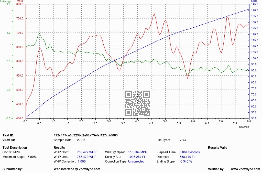

Originally Posted by Fadi
775whp sounds like it should be.
I have just verified an old run from 2014 - 4.9s 60-130s on my rwd 996tt, had it dynoed two days before that run at 916whp on a lower reading dyno than dynojet and ran a bit more boost on the street than at the dyno,
I estimated 950-970whp or so for that street pull as did 0.1bar more than on the dyno, results from vbox dyno were first 1015rwhp (forgot the drag coef to
at 0.34 like the gt2), put drag to 0.31 and result was 995whp, so seems right as my dyno reads a bit lower than dynojet!
Thanks for this great tool, looking forward to trying new runs on my GTR with way more power than before (20Hz version)
OK, I think I've got it all fixed. I resubmitted your file with the fixed software. I'll send you a PM with the link to the results.
Here's your file at the original 20 Hz sampling rate:
Here's your file when I run it at 10 Hz sampling rate:
You can see the results are basically the same. The difference is because of how the graph smoothing works. The graph smoothing averages every four samples. Both 20Hz and 10Hz smooth (average) every four samples. But there's twice as many samples at 20Hz, so the lines look a little jerkier than 10Hz.
Here's what happens when I smooth the 10Hz results to "1" (which means no averaging at all). You'll see here, the results are very jerky, but show a higher peak result. It's admittedly a trade-off. If I want the graphs to look smooth, then I need to average more samples. If you want perfect sample-by-sample results with a jerky looking graph, then no smoothing would be better. Notice there's a 40 whp difference between no averaging and 4-sample averaging. Maybe in the future I'll add a pull-down menu and let the user decide.

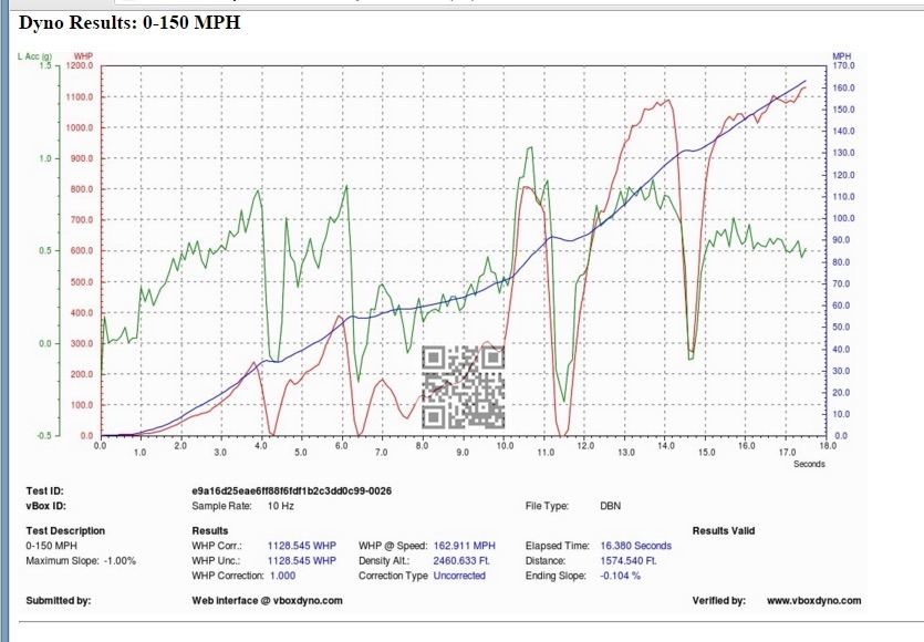

I ran some very old runs as well
More data
1. Tiptronic 996TT 197mph Texas Mile 622hp May 2009
2. BHT: 10.4 ET 1/4 Mile 913hp Feb 2012
3. BHT: Texas Mile 226mph 941hp 2013
4. BHT: TX2K14 March 2014 921hp
5. BHT: TI June 2015 1128hp
Here is a result from TI last year.
More data
What's the difference between #4 and #5? Where did the extra 200 whp come from?
I went from click 3 to click 4.
